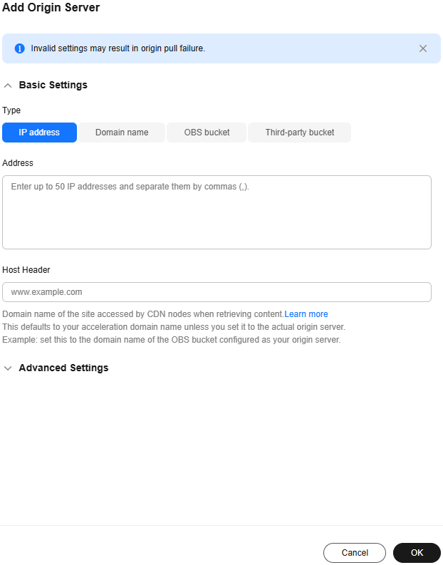

  4. Add an origin server. An origin server is a service server. When a client accesses a resource that is not cached on CDN PoPs, CDN requests the resource from the origin server and returns the resource to the client.
    1. In the Origin Server Settings area, click Add Origin Server to add an origin server for the domain name.
      Figure 3 Adding an origin server
      Table 2 Parameters
      Parameter
      Description
      Type
      Origin server IP address
      • CDN PoPs access the IP address directly to pull origin content.
      • IPv4 is supported, but IPv6 is not supported.
      • If multiple IP addresses are configured, CDN uses load balancing to pull content from the origin server.
      Origin server domain name
      • Start with a letter or digit. Use only letters, digits, hyphens (-), and periods (.). Enter up to 255 characters.
      • Each label of a domain name (for example, *** in ***.***.com) can contain up to 63 characters.
      • An origin domain cannot be the same as an acceleration domain name.
      • You can also enter the domain name of an object storage bucket. Pay attention to the following points when selecting this option:
        1. You cannot use private object storage buckets as origin servers when you set Type to Domain name.
        2. If you use an object storage bucket as your origin server, the object storage service will charge the origin pull traffic based on its billing standards.
        3. When back-to-source by mirroring is configured on OBS and range requests are enabled on CDN, if the mirror origin server does not comply with the RFC Range Requests standard, the response to range requests is not 206. As a result, CDN fails to pull content.
        4. If you use an OBS bucket created after January 1, 2022 as the origin server and want to enable online preview, log in to the CDN console, choose Domains in the navigation pane, click the target domain name, click the Advanced Settings tab, click Edit next to HTTP Headers, and set Content-Disposition to inline. For details, see How Do I Preview OBS Objects in My Web Browser?
      OBS bucket domain name
      Select an OBS bucket domain name under your account or customize one. OBS charges the CDN origin pull traffic based on the billing standard for outgoing Internet traffic. If you set a bucket of OBS 3.0 or a later version as the origin server, you can purchase OBS pull traffic packages to deduct origin pull traffic. For details, see OBS Billing for CDN Acceleration.
      Important notes:
      1. If your OBS private bucket is unsuitable as an origin for your domain name, do not set the private bucket as the origin server.
      2. If you enter a domain name of an OBS bucket, the entered domain name must end with .myhuaweicloud.com or .myhuaweicloud.cn.
      3. If you set an OBS private bucket as the origin server and want to filter user requests, enable OBS authorization and OBS Pull Authentication. Otherwise, origin pull will fail.
      4. To use a custom OBS private bucket as the origin server, configure a policy for the private bucket. For details, see Configuring a Policy for a Custom OBS Private Bucket.
      5. If you have enabled static website hosting for your OBS bucket, select the Static website hosting checkbox when adding a domain name. In this way, a full list of files in the bucket will not be displayed when users access the bucket.
      6. When back-to-source by mirroring is configured on OBS and range requests are enabled on CDN, if the mirror origin server does not comply with the RFC Range Requests standard, the response to range requests is not 206. As a result, CDN fails to pull content. In this case, submit a service ticket.
      7. When Service Type is set to Whole site, the origin server type cannot be set to OBS bucket.
      8. If the origin server is an OBS private bucket, when a client requests the homepage of the acceleration domain name and origin pull is triggered, origin pull can succeed only when the request method is GET or HEAD. For other request methods, CDN blocks the request and returns status code 403.
      NOTE:
      Address
      Address accessed by CDN PoPs during origin pull.
      • If the origin server type is IP address, you can enter multiple IP addresses and separate them with commas (,).
        • Each IP address is an origin server. A domain name can have up to 50 origin servers. The number of IP addresses you can enter cannot exceed the total number of available origin servers of the domain name.
      Host Header
      A host is specified in the HTTP request header. It is the domain name of the site accessed by CDN PoPs when CDN pulls content from the origin server. CDN obtains resources from the corresponding site based on the host details during origin pull.
      After a domain name is added, the default host will be the domain name. Change the host in a timely fashion if either of the following conditions is met:
      • If you set Type to Domain name and enter the domain name of an object storage bucket, set the host to the domain name of the bucket.
      • If you want CDN to pull content from a custom domain name, specify the host. For example, suppose an origin server is bound to two sites, www.origin01.com and www.origin02.com, and the domain name connected to CDN is www.example01.com. If you need CDN to pull content from www.origin02.com, you would need to set the host to www.origin02.com.
      Applies when an OBS bucket is used as an origin server. Enable this switch if access to the bucket requires authentication. In this way, CDN PoPs carry the authentication information during origin pull. If the information does not match the OBS bucket, origin pull fails.
      • Enabled by default for a private bucket
      • Disabled by default for a public bucket
      Priority
      Enter a number from 1 to 1,000. A larger number indicates a higher priority.
      • CDN pulls content from the highest-priority origin server first. If that origin server is faulty, CDN pulls content from a lower-priority origin server.
      • You can configure up to six rules with unique priorities.
        NOTE:
        On April 10, 2025 (Beijing Time), CDN updated the origin server priority function and stopped using the concept of primary and standby origin servers. Currently, the default priorities of the original primary and standby origin servers are as follows:
        • Primary origin server: 70
        • Standby origin server: 30
      Weight
      The value ranges from 1 to 100. A larger value indicates that content is pulled from this origin server more frequently.
      • If there are multiple origin servers with the same priority, the weight determines the proportion of content pulled from each origin server.
      Origin Ports
      Ports for CDN PoPs to pull content. Range: 1 to 65535. Default ports: 80 for HTTP and 443 for HTTPS.
      • If Type is set to OBS bucket, the port numbers cannot be changed.
    2. Click OK. Repeat 4.a to add more origin servers. You can add up to 50 origin servers.
