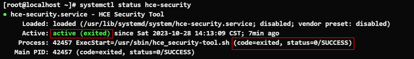

 - Start the hce-security service.
systemctl start hce-security
Run the systemctl status hce-security command to check the service status. If the status is active (exited), the security hardening is successful.
Figure 1 Checking the service status
