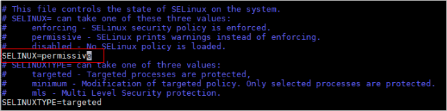

 - Open the configuration file /etc/selinux/config, set SELINUX to permissive, and run the reboot command to restart the OS.
    Figure 1 Setting SELINUX=permissive

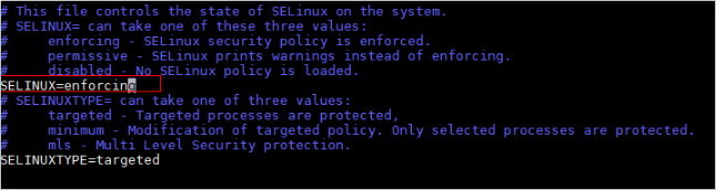

     - Open the configuration file /etc/selinux/config, set SELINUX to enforcing, and run the reboot command to restart the OS.
    Figure 2 Setting SELINUX=enforcing
