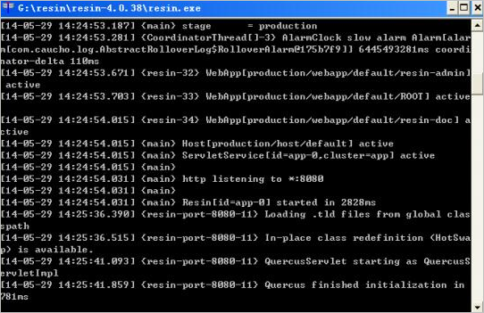

- Run the resin.exe file. During the execution, the command prompt window Figure 1 will display.
- After the resin.exe file is executed. Start the Explorer, enter the default address http://127.0.0.1:8080 of Resin in the address bar, and then press Enter.
If the information similar to Figure 2 is displayed, Resin is installed successfully.
