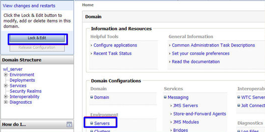

  1. Log in to the management console of the WebLogic server.
  2. Click Lock & Edit in the upper left corner of the page to unlock the configuration.
  3. Click Servers in Domain Configurations.
    Figure 1 Server

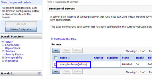

  4. In the server list, select the server for which you want to configure the server certificate. The server configuration page is displayed.
    Figure 2 Target server

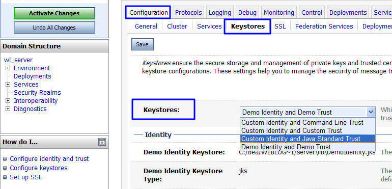

  6. Configure an authentication mode and a key.
    1. On the server configuration page, click the Keystores tab and configure an authentication mode.
      Figure 4 Authentication mode
      • Select Custom Identity and Java Standard Trust for server authentication.
      • Select Custom Identity and Custom Trust for bidirectional authentication.

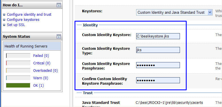

    2. Configure a key in the Identity area.
      Configure the path for storing the keystore file server.jks on the server and enter the password of the keystore file.
      Figure 5 Key
      • Custom Identity Keystore: Enter the path for storing the .jks file. Example: C:\bea\server.jks
      • Custom Identity Keystore Type: Set the file format to jks.
      • Custom Identity Keystore Passphrase: Enter the certificate password, that is, the password in keystorePass.txt.
      • Confirm Custom Identity Keystore Passphrase: Re-enter the certificate password.
