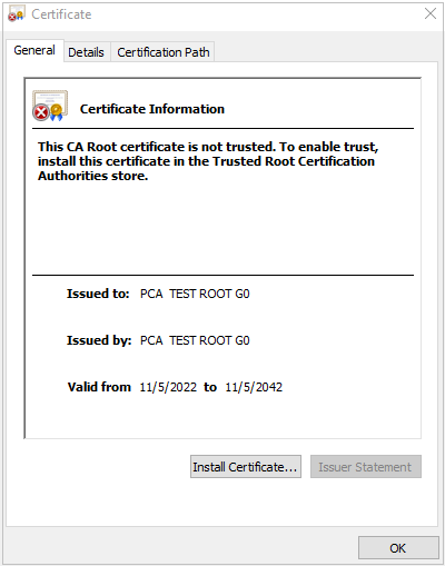

    1. Change the file name extension of the root CA certificate from .pem to .crt. and double-click the certificate file. The root CA certificate information shows that the root certificate is untrusted.
      Figure 1 Root CA not trusted
