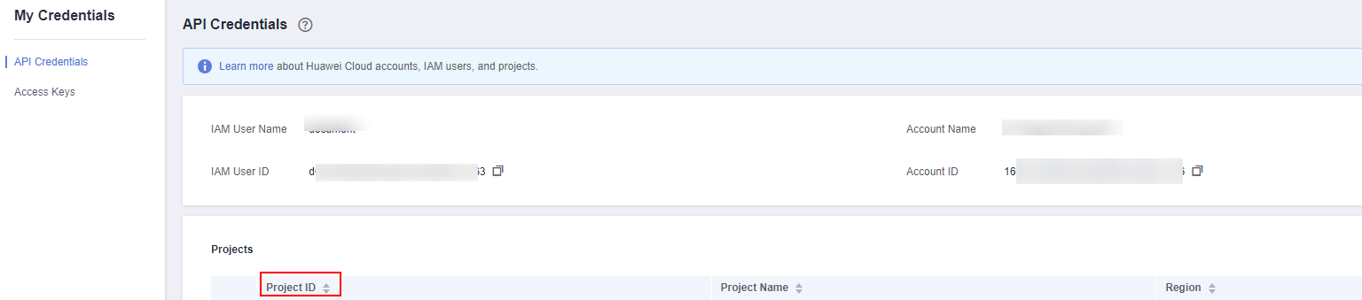

A project ID is required for some URLs when an API is called. To obtain a project ID, perform the following steps:
- Obtain the token.
For details, see Token-based Authentication.
- Obtain the project ID.
The API for obtaining the project ID is GET https://iam.eu-west-0.myhuaweicloud.com/v3/projects.
Add X-Auth-Token to the request header, and set the value of X-Auth-Token to the token obtained in the preceding step.
The following is an example response. id indicates the project ID.
{ "links": {}, "projects": [ { "is_domain": , "description": "", "links": {}, "enabled": true, "id": "", //Project ID "parent_id": "", "domain_id": "", "name": "" }, ... ] }
