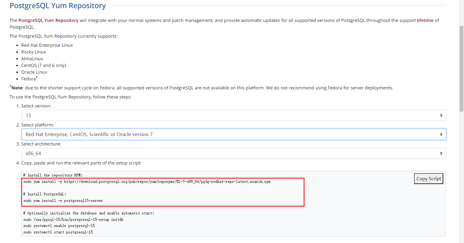

    The PostgreSQL community provides client installation methods for different OSs. You can download and install a client using the installation tool of the OS. This installation method is simple but can be used only for the OSs supported by the PostgreSQL community.
    In this example, CentOS 7 is used. Use the default installation tool of the OS to install a client (PostgreSQL 15 or earlier).
    Figure 1 Obtaining the installation tool
    Run the installation commands:
    sudo yum install -y https://download.postgresql.org/pub/repos/yum/reporpms/EL-7-x86_64/pgdg-redhat-repo-latest.noarch.rpm
    sudo yum install -y postgresql15-server

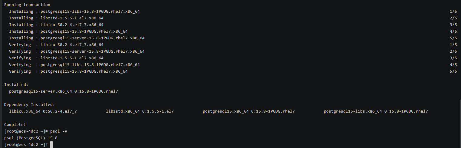

    Check whether the installation is successful.
    psql -V
    Figure 2 Successful installation

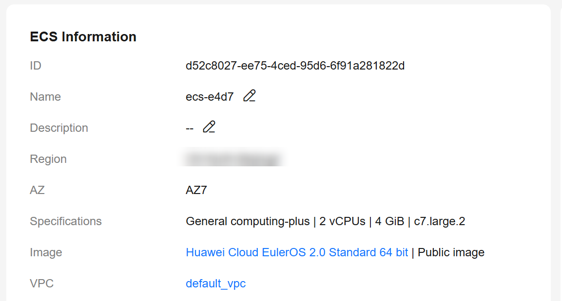

    The following uses an ECS using the Huawei Cloud EulerOS 2.0 image as an example to describe how to install a PostgreSQL 16.4 client.
    Figure 3 Checking the ECS image

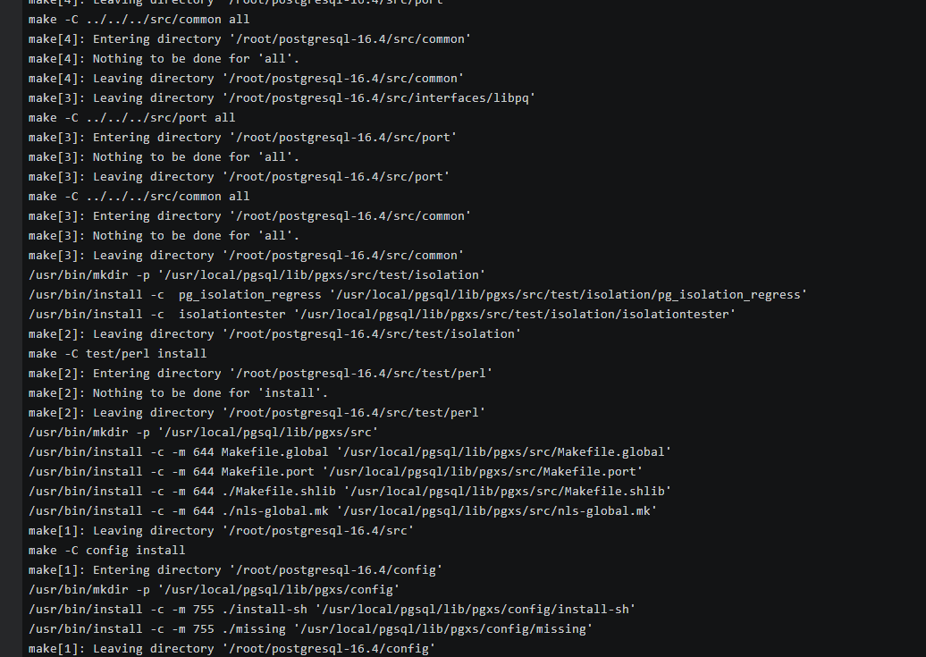

    4. Compile the source code and then install the client.
      cd postgresql-16.4
      ./configure --without-icu --without-readline --without-zlib --with-openssl
      make -j 8 && make install
      If --prefix is not specified, the default path is /usr/local/pgsql. The client can be installed in the simplest way.
      Figure 4 Compilation and installation

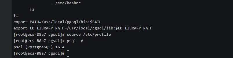

    5. Add the following code to the /etc/profile file to configure environment variables:
      export PATH=/usr/local/pgsql/bin:$PATH
      export LD_LIBRARY_PATH=/usr/local/pgsql/lib:$LD_LIBRARY_PATH
      source /etc/profile
    6. Test whether the psql is available.
      psql -V
      Figure 5 Testing psql
