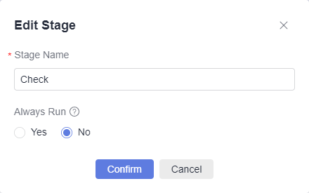

next to Stage_1. In the Edit Stage window, enter the stage name Check and click Confirm. Figure 1 Editing the stage name

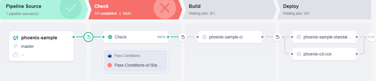

- Click Job, and select From Scratch. The job creation window is displayed on the right.
- Find the Check job in the list, and click Add. Figure 2 Adding the Check job
- Select the phoenix-codecheck-worker task and click OK.
The Check job is displayed.
