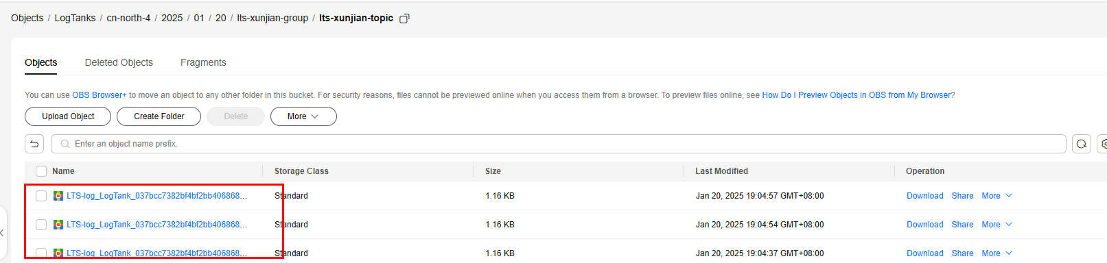

  5. Click OK. When the log transfer status changes to Normal, the transfer task has been created.
  6. Wait for 2 minutes. On the Log Transfer page, click the OBS bucket name in the Transfer Destination column to switch to OBS Console. On the Objects page displayed, click the desired folder name to find the transferred log files LTS-log_xx.json.gz.
    Click Download in the Operation column of these files to download them to your local PC for viewing.

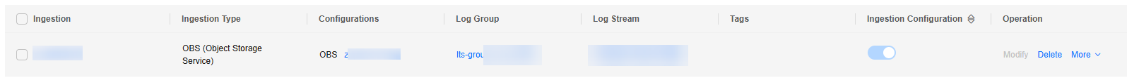

  6. Click Preview to preview the file content. After confirming that the file content is correct, click Submit.
  7. The ingestion configuration is created. Go to the Ingestion Management page to view it.

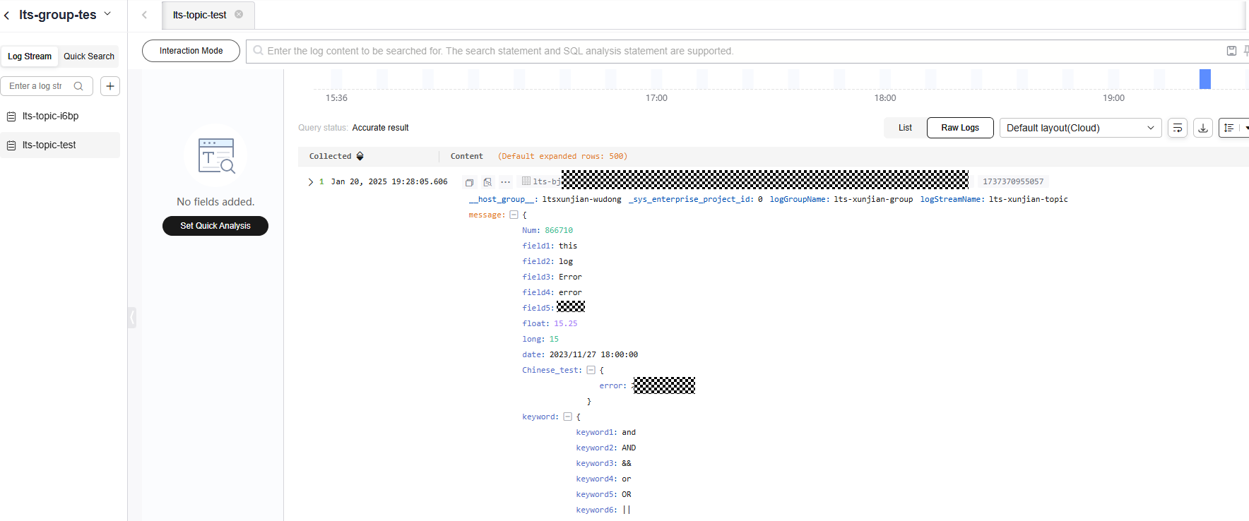

  8. Click the log stream name lts-topic-test to go to its details page and check whether there is data in it. If data exists, the transferred files have been imported to LTS. Compare the log data in log stream lts-xunjian-topic (selected for transferring LTS logs to OBS) with that in log stream lts-topic-test (selected for importing OBS log files to LTS). The log data should be the same.
