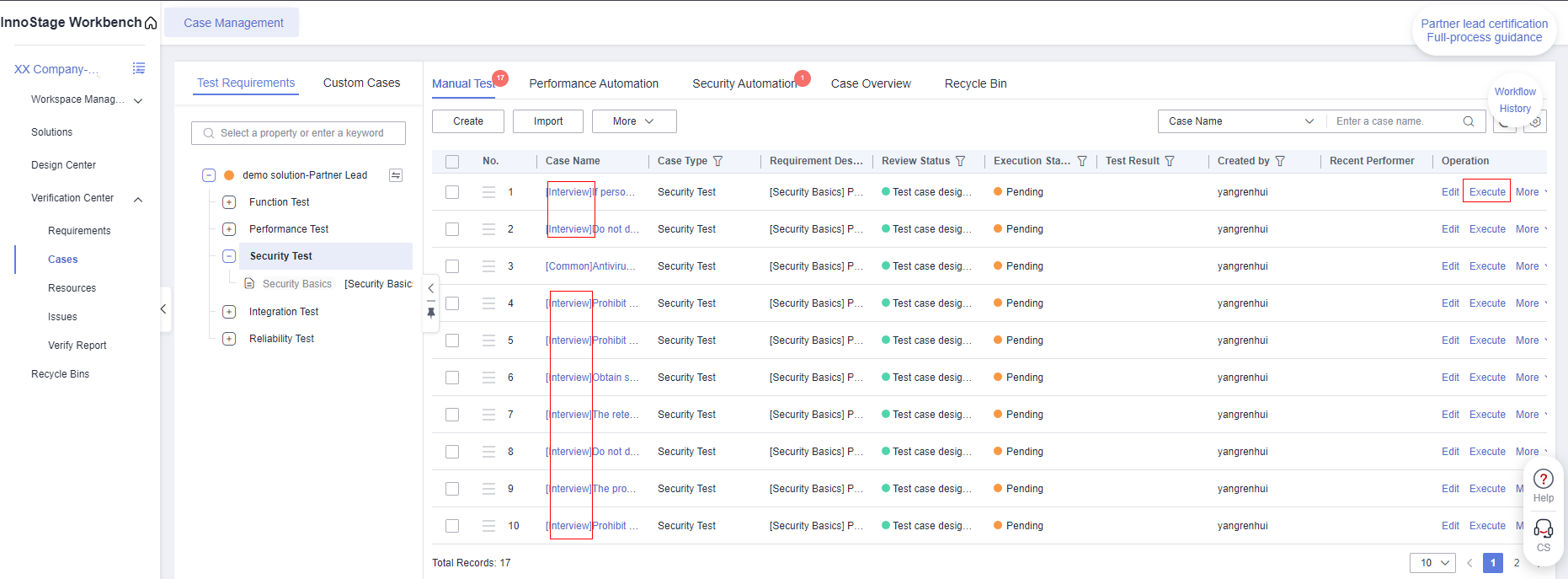

Manual interview case execution
Interview cases are self-checked by partners. The [interview] tag is added to the case name.
The specified partner test case executor click the [Execute] button of an interview case.
Figure 1 Case Management

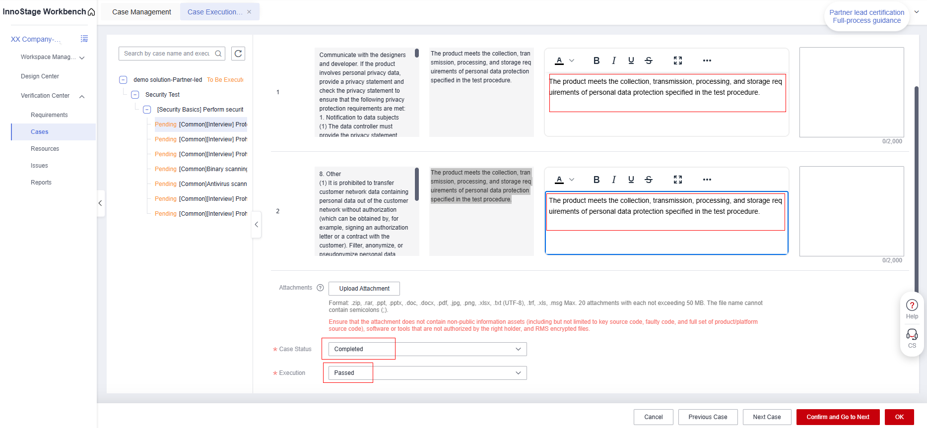

Complete the test case operations according to the test case steps, fill in the actual result, and determine whether the test case is passed based on the expected result.
Table 1 Test case execution information
Information item
Description
Actual Results
Result obtained by following the test procedure of the test case.If the actual result meets the requirements of the expected result, copy the content in the expected result to the actual result.
Case Status
  • Pending:the execution has not started.
  • Executing:the execution is in progress. The execution is not complete.
  • Completed:the execution is complete.
Execution result
  • Failed:the actual structure does not meet the expected result.
  • Pass:the actual structure meets the expectation.
  • Pass conditionally:actual results do not fully match expected results, which can be ignored after confirmation with Huawei test engineers.
  • N/A:the software does not have the functions described in the test case.
File that describes the execution result.
Figure 2 Case Execution
Click [Confirm Go to Next] or [OK].
