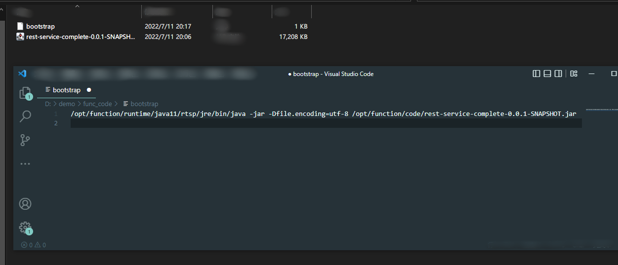

  3. Create a file named bootstrap in the same directory as the JAR file, and enter the startup parameters.
    /opt/function/runtime/java11/rtsp/jre/bin/java -jar -Dfile.encoding=utf-8 /opt/function/code/rest-service-complete-0.0.1-SNAPSHOT.jar
    The Java runtime environment can be directly invoked in the function, and no additional installation is required.
    Figure 3 Inputting startup parameters
  4. Compress the JAR file and bootstrap file into a ZIP package.
