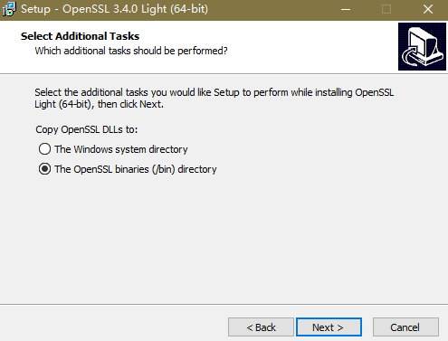

- Download the OpenSSL tool for Windows at https://slproweb.com/products/Win32OpenSSL.html. The latest stable version is 3.4. All earlier versions (including 1.1.1, 1.1.0, 1.0.2, 1.0.0, and 0.9.8) are not supported and should not be used. Download Win64 OpenSSL v3.4.0 Light.
- Double-click the installation package Win64OpenSSL_Light-3.4.0.exe and install it to the default path on drive C. Copy the DLLs to the OpenSSL directory, as shown in the following figure. Retain the default settings in the remaining steps until the installation is complete.

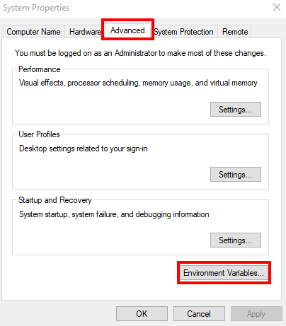

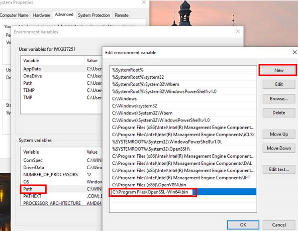

- Install an environment variable. Click Start in the lower left corner of the local PC, right-click This PC, choose More > Properties > View advanced system settings. Switch to the Advanced tab and click Environment Variables.
- In the System variables area, double-click Path and click New in the window displayed. Add the OpenSSL bin path to the last line, for example, C:\Program Files\OpenSSL-Win64\bin, and click OK. Click OK again and the variable is configured successfully.

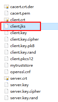

- Convert the format of the client private key.
openssl pkcs12 -export -out client.pkcs12 -in client.crt -inkey client.key
Enter the client private key password Gauss@MppDB. Then enter and confirm the self-defined private key password.
- Import the private key to the keystore.
keytool -importkeystore -deststorepass Gauss@MppDB -destkeystore client.jks -srckeystore client.pkcs12 -srcstorepass Password -srcstoretype PKCS12 -alias 1
- In the preceding command, Password is an example. Replace it with the actual password.
- If information similar to the following is displayed and no error is reported, the import is successful. The target key file client.jks will be generated in C:\dws_ssl_cert\sslcert.

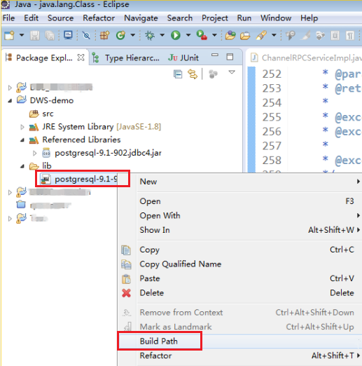

- Add the JAR file to the application project so that applications can reference the JAR file.
Take the Eclipse project as an example. Store the JAR file to the project directory, for example, the lib directory in the project directory. In the Eclipse project, right-click the JAR file in the lib directory and choose Build Path to reference the JAR file.
Figure 1 Referencing a JAR file
