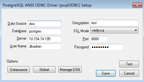

  4. Configure a data source to be connected to.
    1. On the User DSN tab, click Add and choose PostgreSQL Unicode for setup.
      Figure 1 Configuring a data source to be connected to
      You can view the values of Server and Port on the GaussDB(DWS) management console. Log in to the GaussDB(DWS) management console and click Connections. In the Data Warehouse Connection String area, select the target cluster and obtain Private Network Address or Public Network Address. For details, see Obtaining the Cluster Connection Address.
    2. Click Test to verify that the connection is correct. If Connection successful is displayed, the connection is correct.
