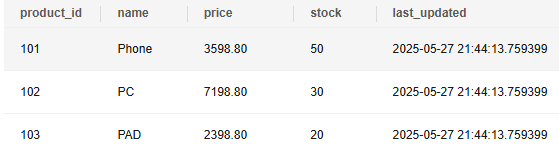

Increase the price of all products by 20% (using a statement without WHERE to update the values of all records).
1 2 | UPDATE products SET price = price * 1.2 , last_updated = NOW(); SELECT * FROM products ORDER BY 1; |

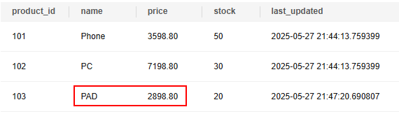

Increase the price of the PAD by 500 (using a statement with WHERE to update the specified data).
1 2 3 | UPDATE products SET price = price + 500 , last_updated = NOW() WHERE name = 'PAD'; SELECT * FROM products ORDER BY 1; |

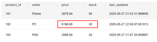

Adjust the price and stock of the PC (Specifying multiple values in SET)
1 2 3 | UPDATE products SET price = price - 1000 , stock = stock - 10, last_updated = NOW() WHERE name = 'PC'; SELECT * FROM products ORDER BY 1; |

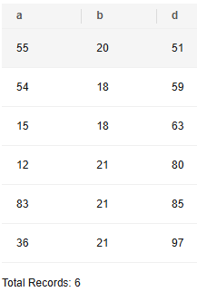

1 2 3 4 5 6 7 8 9 10 11 12 13 14 15 16 17 18 | DROP TABLE IF EXISTS test_range_row; CREATE TABLE test_range_row(a int, b int,d int) DISTRIBUTE BY hash(a) PARTITION BY RANGE(d) ( PARTITION p1 values LESS THAN (60), PARTITION p2 values LESS THAN (75), PARTITION p3 values LESS THAN (90), PARTITION p4 VALUES LESS THAN (maxvalue) ); INSERT INTO test_range_row PARTITION(p1) VALUES(55,20,51); INSERT INTO test_range_row PARTITION(p1) VALUES(54,18,59); INSERT INTO test_range_row PARTITION(p2) VALUES(15,18,63); INSERT INTO test_range_row PARTITION(p3) VALUES(12,21,80); INSERT INTO test_range_row PARTITION(p3) VALUES(83,21,85); INSERT INTO test_range_row PARTITION(p4) VALUES(36,21,97); SELECT * FROM test_range_row ORDER BY d; |

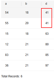

Change the values of column d to 41 in partition p1.
1 2 | UPDATE test_range_row PARTITION(p1) SET d = 41; SELECT * FROM test_range_row ORDER BY d; |
According to the preceding result, the partition is p1, where the values of column d are less than 60. The values of column d in partition p1 are changed to 41.

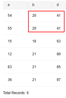

Update the values of column b to 20 in the partition where the partition key value is 41.
1 2 | UPDATE test_range_row PARTITION FOR (41) SET b = 20; SELECT * FROM test_range_row ORDER BY d; |

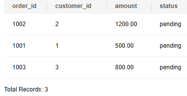

Insert test data and ensure the order status of customers is pending (It means that the orders of the three customers are not processed.)
1 2 3 4 5 6 7 8 9 | INSERT INTO customers VALUES (1,'Tom', 1) (2,'Jack', 3), (3,'Tony', 2); INSERT INTO orders VALUES (1001, 1, 500.00, 'pending'), (1002, 2, 1200.00, 'pending'), (1003, 3, 800.00, 'pending'); SELECT * FROM orders; |

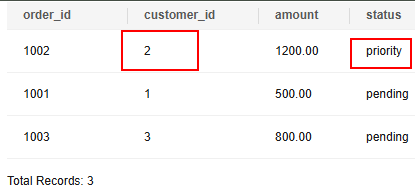

Orders of customers with high VIP levels need be prioritized when there are too many orders. FROM from_list is used to associate the customer ID in the customer table to obtain the customer VIP level. In this example, orders of customers with VIP level 3 or higher need to be processed first.
1 2 3 4 5 6 | UPDATE orders o SET status = 'priority' --Set the order status to priority. FROM customers c WHERE o.customer_id = c.customer_id AND c.vip_level >= 3; --Obtain the customers whose VIP levels are higher than 3 from the customer table. SELECT * FROM orders; |

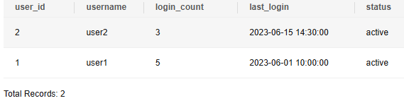

Example: Use DEFAULT to Reset the Status of an Inactive User
Create a user table (with DEFAULT) and insert data.
1 2 3 4 5 6 7 8 9 10 11 12 | DROP TABLE IF EXISTS users; CREATE TABLE users ( user_id INT PRIMARY KEY, --User ID username VARCHAR(50), --Username login_count INT DEFAULT 0, -- Number of login times. The default value is 0. last_login TIMESTAMP, --Last login time status VARCHAR(20) DEFAULT 'active'); --User status. The default value is active. INSERT INTO users (user_id, username, login_count, last_login) VALUES (1, 'user1', 5, '2023-06-01 10:00:00'), (2, 'user2', 3, '2023-06-15 14:30:00'); SELECT * FROM users; |

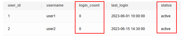

Reset the status and login times of inactive users:
1 2 3 4 5 | UPDATE users SET status = DEFAULT, -- Reset the status to active login_count = DEFAULT -- Reset the login times to 0 WHERE last_login < CURRENT_DATE - INTERVAL '30 days'; SELECT * FROM users; |
