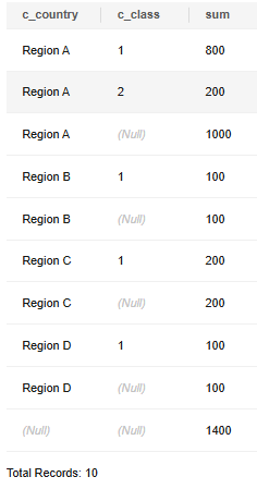

ROLLUP ( { expression | ( expression [, ...] ) } [, ...] )
ROLLUP calculates the standard aggregation value specified by an ordered grouping column in GROUP BY, creates a high-level partial sum from right to left, and finally creates a cumulative sum. A group can be regarded as a series of grouping sets. Example:
GROUP BY ROLLUP (a,b,c)
The preceding condition expression is equivalent to:
GROUP BY GROUPING SETS((a,b,c), (a,b), (a), ( ))
The elements in the ROLLUP clause can be independent fields or expressions, or a list contained in parentheses. If it is a list in parentheses, they must be a whole when the grouping set is generated. Example:
GROUP BY ROLLUP ((a,b), (c,d))
GROUPING SETS ((a,b,c,d), (a,b), (c,d ), ( ))

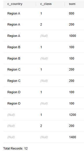

CUBE ( { expression | ( expression [, ...] ) } [, ...] )
A CUBE grouping is an extension to the GROUP BY clause that creates subtotals for all of the possible combinations of the given list of grouping columns (or expressions). CUBE can be understood as all dimensions, that is, all combinations of columns in the aggregation key.
In terms of multidimensional analysis, CUBE generates all the subtotals that could be calculated for a data cube with the specified dimensions. For example, given three expressions (n=3) in the CUBE clause, the operation results in 2n = 23 = 8 groupings. Rows grouped on the values of n expressions are called regular rows, and the rest are called superaggregate rows. Example:
GROUP BY CUBE (a,b,c)
GROUP BY GROUPING SETS((a,b,c), (a,b), (a,c), (b,c), (a), (b), (c), ( ))
The elements in the CUBE clause can be independent fields or expressions, or a list contained in parentheses. If it is a list in parentheses, they must be a whole when the grouping set is generated. Example:
GROUP BY CUBE (a, (b, c), d)
GROUP BY GROUPING SETS ((a,b,c,d), (a,b,c), (a), ( ))
Examples

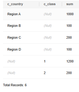

GROUPING SETS ( grouping_element [, ...] )
GROUPING SETS is another extension to the GROUP BY clause. It allows users to specify multiple GROUP BY clauses. The option is used to define a grouping set. Each grouping set needs to be included in a separate parenthesis. A blank parenthesis (()) indicates that all data is processed as a group. This improves efficiency by trimming away unnecessary data. You can specify the required data group for query.
NOTICE:
If the SELECT list expression quotes some ungrouped fields and no aggregate function is used, an error is displayed. This is because multiple values may be returned for ungrouped fields.
Examples

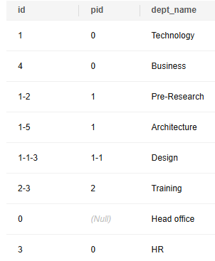

Query the original data of the table. In the command output, it is difficult to determine the relationship of the three levels of departments.
SELECT * FROM departments;

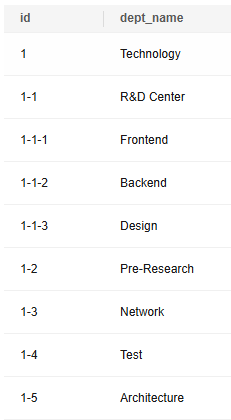

In this case, use the keyword WITH RECURSIVE to query all level-2 and level-3 departments under the technology department.
 2
 3
 4
 5
 6
 7
 8
 9
10
11
WITH RECURSIVE  t1 AS (         -- Define a common expression named t1.
SELECT id,pid,dept_name FROM departments WHERE id='1'   -- Initialize the recursive root node: Query the record whose ID is 1, that is, the technology department.
UNION ALL         --Recursively combine results (duplicate items are retained).
SELECT            --Recursive part: query data layer by layer.
t2.id,            --Subnode ID, that is, the name of each level-1 department.
t2.pid,            --Parent node ID, that is, the head office.
t2.dept_name          --Subnode name.
FROM departments t2
INNER JOIN t1 ON t2.pid = t1.id          --Connect the recursive result through the parent node ID.
SELECT id,dept_name FROM t1 ORDER BY id;       --(Final query) All level-2 and level-3 departments are displayed by ID.

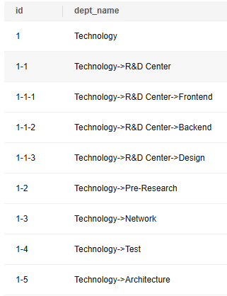

SELECT    --Initialize the root node of recursion: Query the record whose ID is 1, that is, the technology department, and convert data type from record to text.
 id,
 pid,
dept_name::text -- Explicitly convert the data type to text (prepared for subsequent path concatenation).
FROM departments
WHERE id='1'
UNION ALL
SELECT    --Recursive part: concatenate the level path.
t2.id,
t2.pid,
(t1.dept_name||'->'||t2.dept_name)::text AS dept_name   --Concatenate the parent path and the current node name, for example, Technology -> R&D Center.
FROM departments t2
INNER JOIN t1 ON t2.pid = t1.id )
SELECT id,dept_name FROM t1 ORDER BY id;   --(Final query) Display the result with the level path

    ROLLUP generates subtotals and grand totals across multiple levels of aggregation within a single query. It starts from the most detailed level of aggregation and progressively rolls up to less detailed levels, ultimately producing a grand total.
    2
    -- Group by c_country and c_class, then group by c_country, and finally group by the entire table.
    SELECT c_country, c_class, sum(c_balance) FROM customer GROUP BY ROLLUP(c_country, c_class) ORDER BY 1,2,3;
    The preceding statement is equivalent to:
    2
    3
    4
    SELECT c_country, c_class, SUM(c_balance) FROM customer GROUP BY c_country, c_class UNION ALL
    SELECT c_country, null, SUM(c_balance) FROM customer GROUP BY c_country
    UNION ALL
    SELECT null, null, SUM(c_balance) FROM customer ORDER BY 1,2,3;
  • CUBE:
    2
    -- Perform GROUP BY on (c_country,c_class), (c_country), and (c_class) in sequence, and on the entire table.
    SELECT c_country, c_class, SUM(c_balance) FROM customer GROUP BY CUBE(c_country, c_class) ORDER BY 1,2,3;
    2
    3
    4
    5
    6
    7
    union all
    union all
    union all
    SELECT NULL, c_class, SUM(c_balance) FROM customer GROUP BY c_class order by 1,2,3;
  • GROUPING SETS:
    GROUPING SETS is different from ROLLUP and CUBE. It extracts some records from the results of ROLLUP and CUBE.
    2
    -- Perform GROUP BY on (c_class) and (c_country) separately.
    SELECT c_country, c_class, SUM(c_balance) FROM customer GROUP BY GROUPING SETS(c_country, c_class) ORDER BY 1,2,3;
    2
    3
    UNION ALL
    SELECT null, c_class, sum(c_balance) FROM customer GROUP BY c_class ORDER BY 1,2,3;
