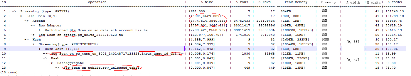

During the test at a site, if the following execution plan is performed, the customer expects that the performance can be improved and the result can be returned within 3s.
Optimization Analysis
It is found that the row engine is used after analysis, because both the temporary plan table input_acct_id_tbl and the medium result dumping table row_unlogged_table use a row-store table.

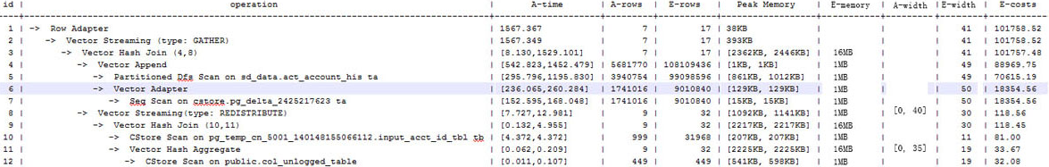

After the two tables are changed into column-store tables, the system performance is improved and the result is returned by 1.6s.
