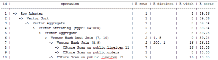

The following figure shows the execution plan. (When verbose is used, distinct is added for column selection which is controlled by cost off/on. The hash join rows show the estimated number of distinct values and the other rows do not.)
Scenario 1: After Optimization
These queries are from Anti Join connected in the lineitem table. When cost_param & bit0 is 0, the estimated number of Anti Join rows greatly differs from that of the actual number of rows, compromising the query performance. You can estimate the number of Anti Join rows more accurately by setting cost_param & bit0 to 1 to improve the query performance. The optimized execution plan is as follows:

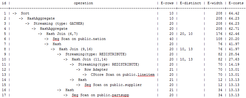

If bit1 is set to 1 (set cost_param=2), the selection rate is estimated based on multiple filter criteria. The lowest selection rate among all filter criteria, but not the product of the selection rates for two tables under a specific filter criterion, is used as the total selection rate. This method is more accurate when a close correlation exists between the columns to be filtered. The following example describes the optimization scenario when bit1 of cost_param is set to 1.
The table structure is as follows:
1 2 3 4 5 6 7 8 9 10 11 12 13 14 15 16 17 18 19 20 21 22 23 24 25 | CREATE TABLE NATION ( N_NATIONKEYINT NOT NULL , N_NAMECHAR(25) NOT NULL , N_REGIONKEYINT NOT NULL , N_COMMENTVARCHAR(152) ) distribute by replication; CREATE TABLE SUPPLIER ( S_SUPPKEYBIGINT NOT NULL , S_NAMECHAR(25) NOT NULL , S_ADDRESSVARCHAR(40) NOT NULL , S_NATIONKEYINT NOT NULL , S_PHONECHAR(15) NOT NULL , S_ACCTBALDECIMAL(15,2) NOT NULL , S_COMMENTVARCHAR(101) NOT NULL ) distribute by hash(S_SUPPKEY); CREATE TABLE PARTSUPP ( PS_PARTKEYBIGINT NOT NULL , PS_SUPPKEYBIGINT NOT NULL , PS_AVAILQTYBIGINT NOT NULL , PS_SUPPLYCOSTDECIMAL(15,2)NOT NULL , PS_COMMENTVARCHAR(199) NOT NULL )distribute by hash(PS_PARTKEY); |
The query statements are as follows:
1 2 3 4 5 6 7 8 9 10 11 12 13 14 15 16 17 18 19 20 21 22 | set cost_param=2; explain verbose select nation, sum(amount) as sum_profit from ( select n_name as nation, l_extendedprice * (1 - l_discount) - ps_supplycost * l_quantity as amount from supplier, lineitem, partsupp, nation where s_suppkey = l_suppkey and ps_suppkey = l_suppkey and ps_partkey = l_partkey and s_nationkey = n_nationkey ) as profit group by nation order by nation; |

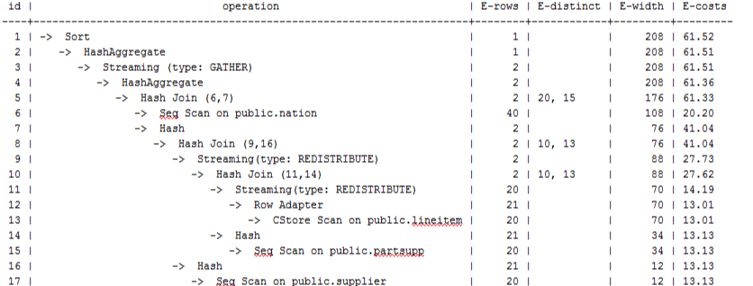

When bit1 of cost_param is 0, the execution plan is shown as follows:
Scenario 2: After Optimization
In the preceding queries, the hash join criteria of the supplier, lineitem, and partsupp tables are setting lineitem.l_suppkey to supplier.s_suppkey and lineitem.l_partkey to partsupp.ps_partkey. Two filter criteria exist in the hash join conditions. lineitem.l_suppkey in the first filter criteria and lineitem.l_partkey in the second filter criteria are two columns with strong relationship of the lineitem table. In this situation, when you estimate the rate of the hash join conditions, if cost_param & bit1 is 0, the selection rate is estimated based on multiple filter criteria. The lowest selection rate among all filter criteria, but not the product of the selection rates for two tables under a specific filter criterion, is used as the total selection rate. This method is more accurate when a close correlation exists between the columns to be filtered. The plan after optimization is shown as follows:
