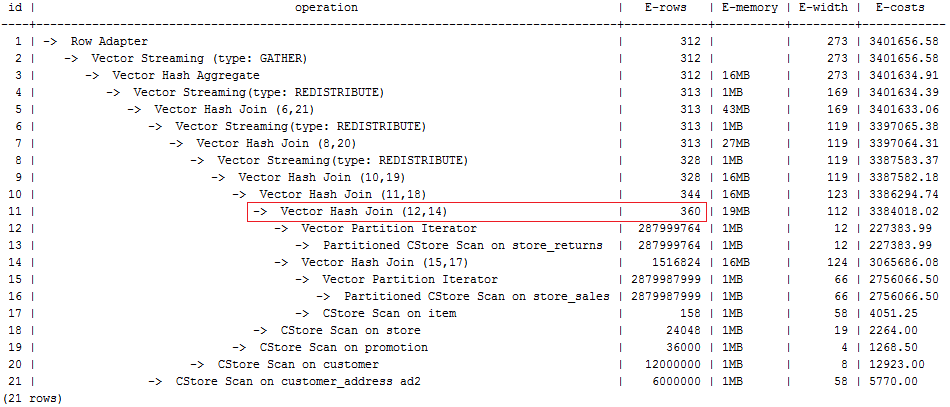

Hint the query plan in Examples as follows:
2
explain
select /*+ rows(store_sales store_returns *50) */ i_product_name product_name ...
Multiply the result set of joined store_sales and store_returns by 50. The optimized plan is as follows:
The estimation value after the hint in row 11 is 360, and the original value is rounded off to 7.
