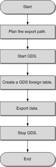

Data Export Process
Figure 2 Concurrent data export
Table 1 Process description
Process
Description
Subtask
Plan data export.
Prepare data to be exported and plan the export path for the mode to be selected.
For details, see Planning Data Export.
Start GDS.
If the Remote mode is selected, install, configure, and start GDS on data servers.
For details, see Installing, Configuring, and Starting GDS.
Create a foreign table,
Create a foreign table to help GDS specify information about a data file. The foreign table stores information, such as the location, format, encoding, and inter-data delimiter of a data file.
For details, see Creating a GDS Foreign Table.
Export data.
After the foreign table is created, run the INSERT statement to efficiently export data to data files.
For details, see Exporting Data.
Stop GDS.
Stop GDS after data is exported.
For details, see Stopping GDS.
