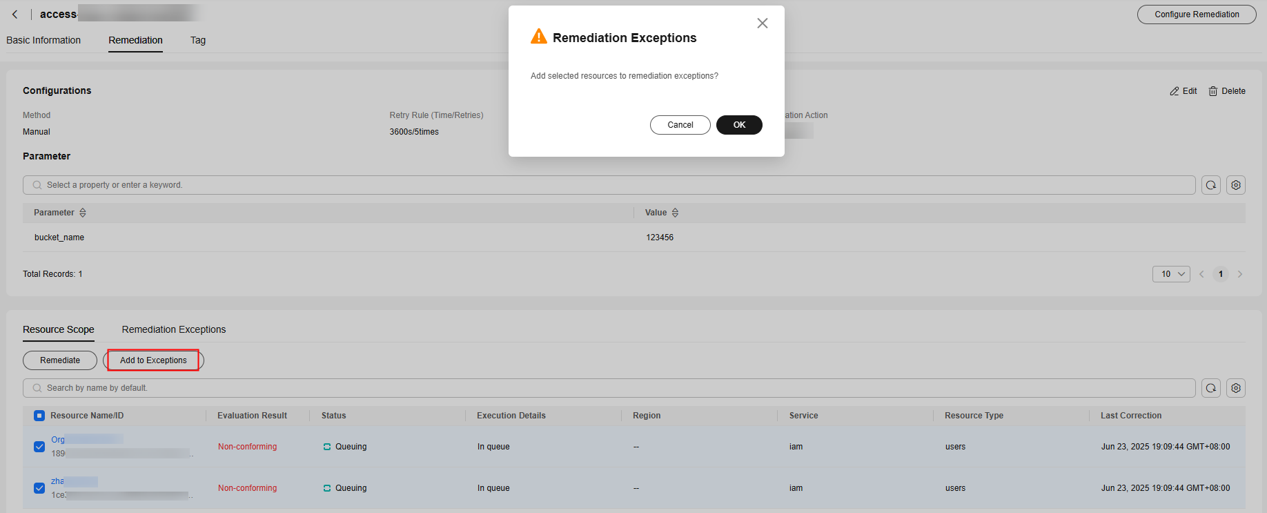

Manually Adding an Exception
 - Click
 in the upper left corner of the page. Under Management & Governance, select Config. - In the navigation pane on the left, choose Resource Conformance.
 - On the Rules tab, click the name of a rule that has remediation configured to go to the details page.
 - Click the Remediation tab.
 - In the Resource Scope pane in the lower part of the page, select target non-compliant resources and click Add to Exceptions.
 - In the displayed dialog box, click OK.
    Figure 1 Adding exceptions
     - Click the Remediation Exceptions tab to check the added resources.

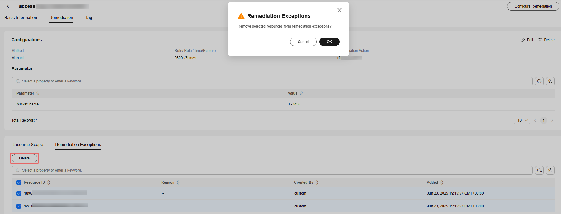

Deleting a Remediation Exception
 - Click
 - Select target non-compliant resources and click Delete above the list.
    Figure 2 Deleting a remediation exception
