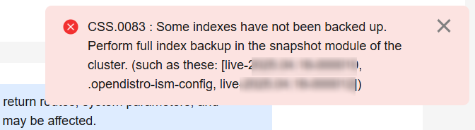

- Click OK. The system performs a pre-upgrade check. If the check passes, the upgrade process begins.
If the pre-upgrade check fails, error information is displayed in the upper right corner of the console. Adjust the cluster configuration accordingly and try again.
Figure 1 Upgrade check errors

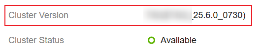

- Confirm the upgrade result.
In the cluster list, find the target cluster, and check the cluster version in the Version column to see if the upgrade is successful.
