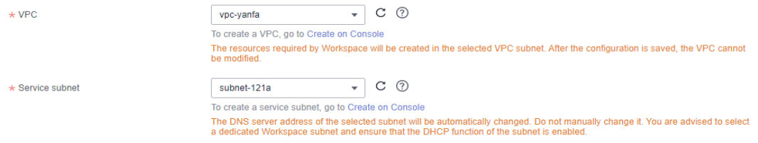

  1. Configure VPC and Service Subnet, as shown in Figure 1.
    Figure 1 VPC and service subnet
    • To configure an existing VPC, select an existing VPC and service subnet.
    • To configure a new VPC, click Create on Console, and create a VPC and service subnet. For details, see Creating a VPC.
    • The resources required by Workspace will be created in the selected VPC subnet. After the desktop is purchased for the first time, the VPC cannot be modified.
    • A VPC is an isolated, configurable, and manageable virtual network environment for cloud desktops, facilitating internal network management and configuration. Your cloud desktops will be created in the selected VPC subnet for your access to the resources and applications on the enterprise intranet.
    • Each desktop has a network interface card (NIC) of a service subnet. The service subnet is used to interconnect desktops and cloud hosts or enterprise intranets for easy access of applications and resources on cloud hosts or enterprise intranets.
    • The DNS server address of the selected subnet will be automatically changed. Do not manually change it. You are advised to select a dedicated Workspace subnet and ensure that the DHCP function is enabled for the subnet.
