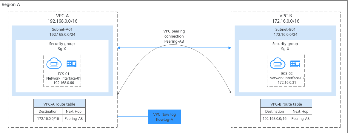

Solution Architecture
In this example, a VPC peering connection Peer-AB is used to enable communications between two VPCs (VPC-A and VPC-B). If O&M engineers need to view the traffic between the two VPCs, you can create a VPC flow log and collect the flow log of VPC-A.
Figure 1 Viewing traffic between VPCs connected by a VPC peering connection

Resource Planning
In this example, the VPCs, subnets, ECSs, VPC peering connection, and VPC flow log must be in the same region but can be in different AZs.
The following resource details are only for your reference. You can modify them if needed.
Table 1 Resource planning
Resource
Quantity
Description
VPC and subnet
VPC: 2
Subnet: 2
  • VPC name: Set it as needed. In this example, VPC-A and VPC-B are used.
  • IPv4 CIDR Block (VPC): Set it as needed. In this example, 192.168.0.0/16 is used for VPC-A, and 172.16.0.0/16 is used for VPC-B.
  • Subnet name: Set it as needed. In this example, Subnet-A01 and Subnet-B01 are used.
  • IPv4 CIDR Block (Subnet): Set it as needed. In this example, the CIDR block of Subnet-A01 is 192.168.0.0/24 and that of Subnet-B01 is 172.16.0.0/24.
  • Route table: A VPC comes with a default route table. In this example, the default route table of VPC-A is rtb-VPC-A, and that of VPC-B is rtb-VPC-B.
ECS
2
Configure the two ECSs as follows:
  • ECS Name: Set it as needed. In this example, the ECSs are named ECS-01 and ECS-02.
  • ECS flavor: In this example, flow logs of the network interface attached to ECS-01 are collected. Select the ECS flavor that supports flow logs. For details, see Constraints. There are no such restrictions on selecting the flavor for ECS-02.
  • Image: Set it as needed. In this example, public image Huawei Cloud EulerOS 2.0 Standard 64 bit is used.
  • System Disk: In this example, a general-purpose SSD disk of 40 GiB is used.
  • Data Disk: Set it as needed. In this example, no data disk is used.
  • Network
    • VPC: Select your required VPC. In this example, select VPC-A for ECS-01 and VPC-B for ECS-02.
    • Subnet: Select your required subnet. In this example, select Subnet-A01 for ECS-01 and Subnet-B01 for ECS-02.
  • Security Group: In this example, the two ECSs are associated with the same security group (Sg-X). Ensure that all rules in Table 2 are added.
    If the ECSs are associated with different security groups, you also need to add additional rules.
    For example, if ECS-01 is associated with Sg-X and ECS-02 is associated with Sg-A, add the rules in Table 3 to Sg-X and Sg-A to allow the two ECSs to communicate with each other.
  • EIP: Select Not required.
  • Private IP address: In this example, use 192.168.0.66 for ECS-01 and 172.16.0.31 for ECS-02.
  • VPC Peering Connection Name: Set it as needed. In this example, Peering-AB is used.
  • Local VPC: Set it as planned. In this example, select VPC-A with the CIDR block of 192.168.0.0/16.
  • Account: Set it as planned. In this example, select My account, indicating that the VPCs connected by the VPC peering connection are in the same account.
  • Peer VPC: Set it as planned. In this example, select VPC-B with the CIDR block of 172.16.0.0/16.
  • Routes: After the VPC peering connection is created, you need to add routes to the route tables of the local and peer VPCs to connect them. For details about the required routes in this example, see Table 4.
VPC flow log
  • Name: Set it as needed. In this example, name it flowlog-A.
  • Resource Type: In this example, set it to VPC.
  • Resource: Select a resource as needed. In this example, select VPC-A with the CIDR block of 192.168.0.0/16.
  • Filter: Select All traffic in this example.
  • Log Group: Select an existing or create a log group. The log group of this example is as follows:
    • Log Group Name: Set it as needed. In this example, lts-group-A is used.
    • Log Retention (Days): Set it as needed. In this example, 30 is used.
  • Log Stream: Select an existing or create a log stream. The log stream of this example is as follows:
    • Log Group Name: In this example, the log group name is lts-group-A.
    • Log Stream Name: Set it as needed. In this example, lts-topic-A is used.
    • Log Storage: You are advised to enable this function for log search and analysis.

Table 3 Rules of security groups Sg-X and Sg-A
Security Group
Direction
Action
Type
Protocol & Port
Source
Description
Sg-X
Inbound
Allow
IPv4
All
Security group Sg-A
Allows IPv4 traffic from ECSs in Sg-A to reach ECSs in Sg-X.
Sg-A
Inbound
Allow
IPv4
All
Security group Sg-X
Allows IPv4 traffic from ECSs in Sg-X to reach ECSs in Sg-A.
Table 4 VPC route tables
VPC Name
Route Table
Destination
Next Hop Type
Next Hop
Route Type
VPC-A
Default route table: rtb-VPC-A
VPC-B CIDR block: 172.16.0.0/16
Peering-AB
Custom
VPC-B
Default route table: rtb-VPC-B
VPC-A CIDR block: 192.168.0.0/16
Peering-AB
Custom
