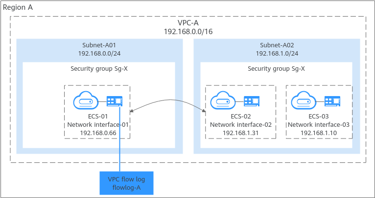

Solution Architecture
In this example, there are two subnets (Subnet-A01 and Subnet-A02) in a VPC (VPC-A). ECS-01 is running in Subnet-A01 and ECS-02 and ECS-03 are running in Subnet-A02. ECS-01 communicates with both ECS-02 and ECS-03. If something goes wrong with the communications between ECS-01 and ECS-02, the O&M engineer needs to check the traffic between the two ECSs. To locate issues, the O&M engineer needs to create a VPC flow log and collect the flow log of the network interface attached to ECS-01.
Figure 1 Viewing the traffic of ECSs in a VPC

Resource Planning
In this example, the VPC, subnets, flow log, and ECSs must be in the same region but can be in different AZs.
The following resource details are only for your reference. You can modify them if needed.

VPC flow log
  • Name: Set it as needed. In this example, name it flowlog-A.
  • Resource Type: Select NIC in this example.
  • Resource: Set it as needed. In this example, select the network interface (IP address: 192.168.0.66) of ECS-01.
  • Filter: Select All traffic in this example.
  • Log Group: Select an existing or create a log group. The log group of this example is as follows:
    • Log Group Name: Set it as needed. In this example, lts-group-A is used.
    • Log Retention (Days): Set it as needed. In this example, 30 is used.
  • Log Stream: Select an existing or create a log stream. The log stream of this example is as follows:
    • Log Group Name: In this example, the log group name is lts-group-A.
    • Log Stream Name: Set it as needed. In this example, lts-topic-A is used.
    • Log Storage: You are advised to enable this function for log search and analysis.
