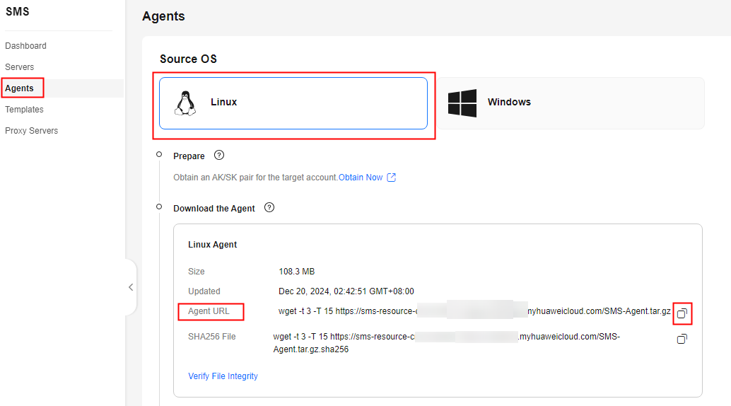

- Sign in to the SMS console.
- In the navigation pane on the left, choose Agents.
- Select the Linux card, and in the Linux Agent area, click the
icon next to Agent URL to copy the Agent download command. Run the command on the source server to download the Agent installation package.

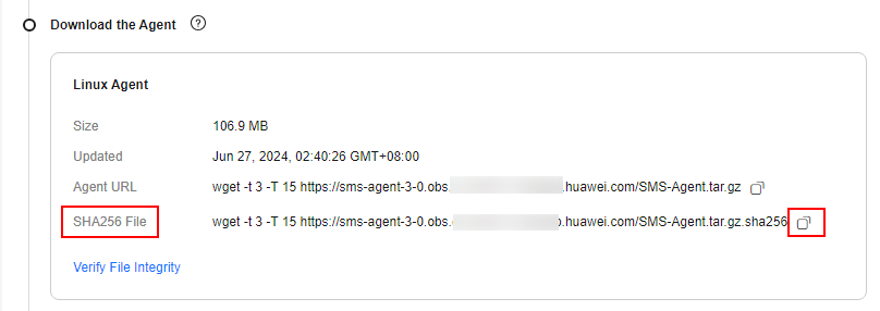

- Copy the command next to SHA256 File and run the command on the source server. Use the hash value contained in the SHA256 file to verify the integrity of the Agent installation package. For details, see How Do I Verify the Integrity of the Agent Installation File?

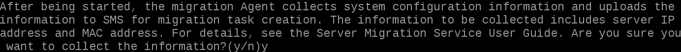

- Read the displayed information carefully, enter y, and press Enter. Figure 1 Entering y

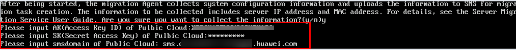

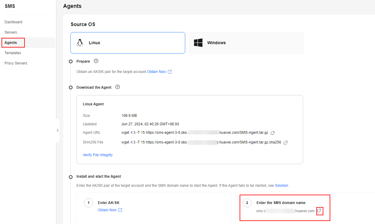

- Enter the AK/SK pair for the Huawei Cloud account and the SMS domain name for the region you are migrating to. You can obtain the SMS domain name on the Agents page of the SMS console, as shown in Figure 3. Figure 2 Entering the AK/SK pair

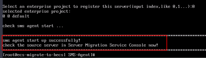

If the EPS service has been enabled for the Huawei Cloud account, after you entered the AK/SK pair, the Agent will list all enterprise projects the account is allowed to access. You can select the enterprise project you would like to migrate the source server to. This enables you to isolate permissions, resources, and finance during the migration. For details, see Migrating Servers into an Enterprise Project.
When the following information is displayed, the Agent has been started up and will automatically start reporting source server information to SMS. You can go to the Servers page on the SMS console to view the record of the source server.Figure 4 Agent running
