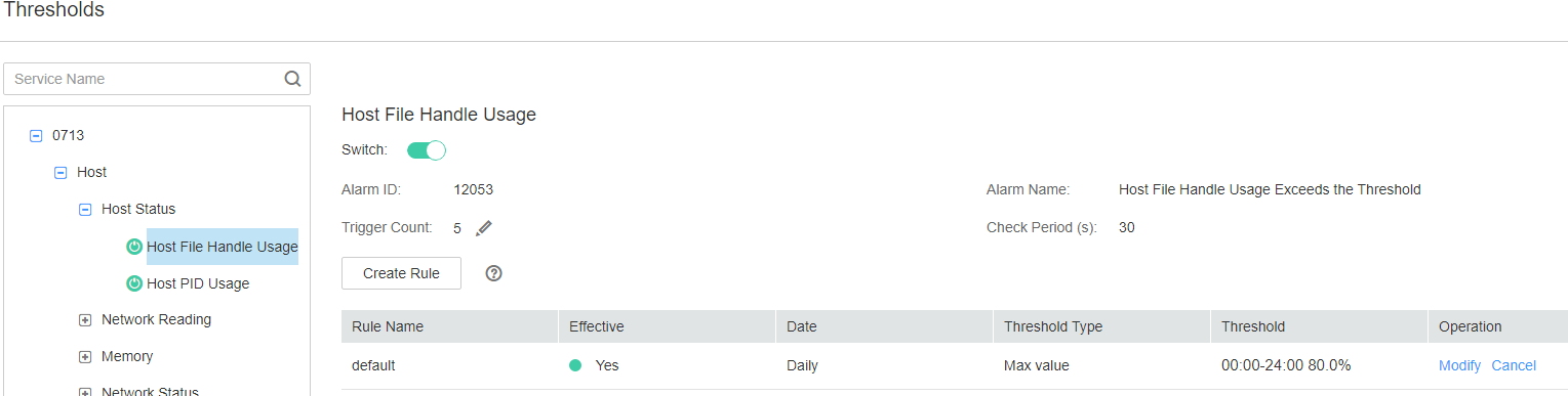

- Choose O&M > Alarm > Thresholds.
- Select a monitoring metric for a host or service in the cluster. Figure 1 Configuring the threshold for a metric
For example, after selecting Host Memory Usage, the information about this indicator threshold is displayed.- If the alarm sending switch is turned on, an alarm will be triggered if the threshold is reached.
- When Alarm Severity is on, hierarchical alarms are enabled. The system dynamically reports alarms at each severity based on the real-time metric values and hierarchical thresholds set for the severity. MRS 3.3.0 or later supports this function.
- Alarm ID and Alarm Name: alarm information triggered against the threshold
- Trigger Count: MRS Manager checks whether a metric value reaches the threshold. If it reaches the threshold for the specified number of consecutive checks, the system generates an alarm. You can configure this trigger count.
- Check Period (s): interval for the system to check the monitoring metric.
- The rules in the rule list are used to trigger alarms.
- Click Create Rule to add rules used for monitoring indicators.

- Click OK to save the rules.
- In the row of the target rule, click Apply in the Operation column.
A new rule can be applied only after you click Cancel for an existing rule.
On the Thresholds page, check whether Effective for the new rule is set to Yes. You can also check whether the alarm is generated or cleared as expected on the O&M > Alarms page.
