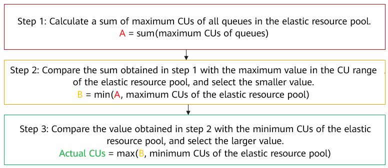

Triggering Methods for Scaling Out or In an Elastic Resource Pool
| Operation | Actual CU Change | Trigger Method |
| Scaling out | Actual CUs increase. | max{(min[sum(maximum CUs of queues), maximum CUs of the elastic resource pool]), minimum CUs of the elastic resource pool} > current actual CUs, the system automatically scales out. |
| Scaling in | Actual CUs decrease. | max{(min[sum(maximum CUs of queues), maximum CUs of the elastic resource pool]), minimum CUs of the elastic resource pool} < current actual CUs, the system automatically scales in. |
For details, see Figure 1.
Formula for Calculating Actual CUs of an Elastic Resource Pool
The actual CUs of an elastic resource pool must meet the following requirements:
- Meet the demands of all queues.
- Ensure that it does not exceed the upper limit of the CUs of the elastic resource pool.
- Ensure that it is not below the lower limit of the CUs of the elastic resource pool.

At the next full hour, the system automatically compares the actual CUs with max{(min[sum(maximum CUs of queues), maximum CUs of the elastic resource pool]), minimum CUs of the elastic resource pool}.
If max{(min[sum(maximum CUs of queues), maximum CUs of the elastic resource pool]), minimum CUs of the elastic resource pool} > current actual CUs, the system triggers scale-out. The calculation method for the actual CUs after scale-out can be found in Figure 1.
