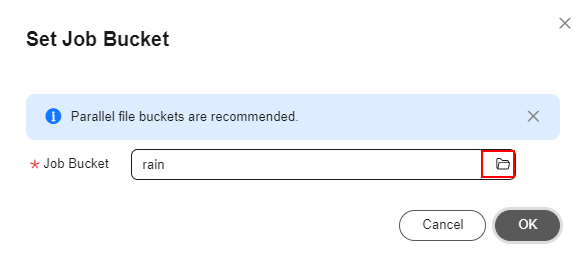

Configuring a Bucket for DLI Jobs
- In the navigation pane of the DLI console, choose Global Configuration > Project.
- On the Project page, click
next to Job Bucket to configure bucket information. Figure 1 Project
- Click
to view available buckets. - In the displayed OBS dialog box, click the name of a bucket or search for and click a bucket name and then click OK. In the Set Job Bucket dialog box, click OK. Temporary data generated during DLI job running will be stored in the OBS bucket.Figure 2 Setting the job bucket

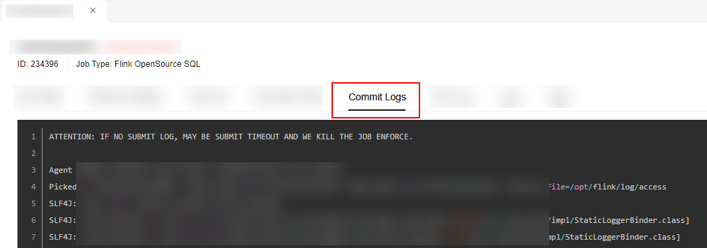

Viewing Commit Logs
You can check commit logs to locate commit faults.
- In the navigation pane of the DLI console, choose Job Management > Flink Jobs.
- Click the name of the Flink job whose commit logs you want to check.
- Click the Commit Logs tab and check the job commit process. Figure 3 Commit logs

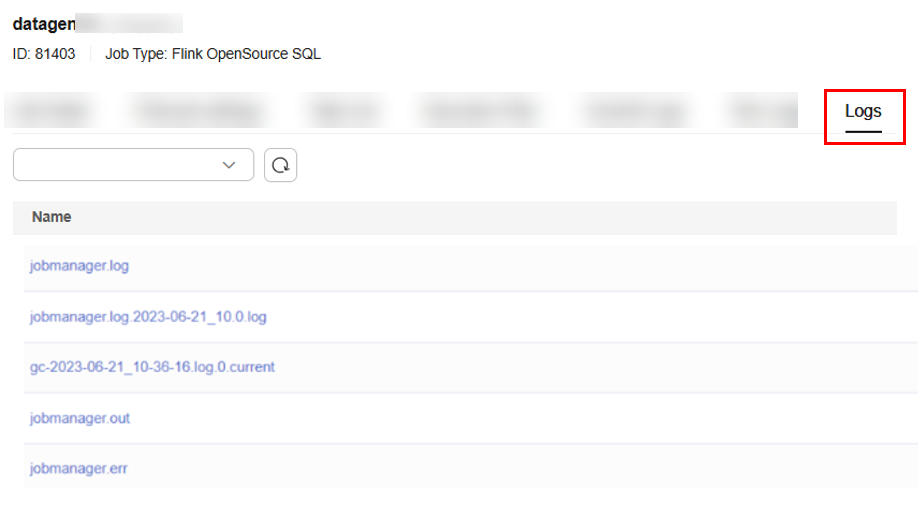

Viewing the Log List
You can view historical job files by viewing the Flink job log list.
- Click the name of your desired job.
- On the Logs tab page, choose Job Manager and Task Manager separately to view their logs. Figure 5 Flink job log list
