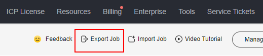

- In the left navigation pane of the DLI management console, choose > . The Flink Jobs page is displayed.
- Click Export Job in the upper right corner. The Export Job dialog box is displayed. Figure 2 Exporting a job
- Select the OBS bucket where the job is stored. Click Next.
- Select job information you want to export.
By default, configurations of all jobs are exported. You can enable the Custom Export function to export configurations of the desired jobs.
- Click Confirm to export the job.
