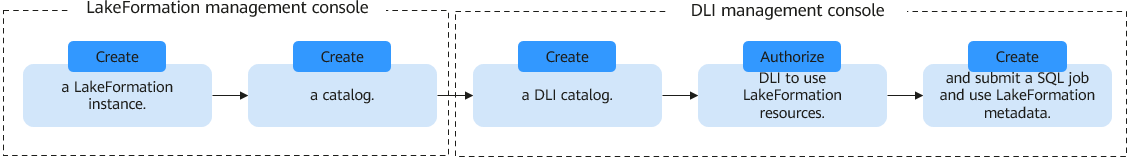

Procedure

Step 1: Create a LakeFormation Instance for Metadata Storage

Step 2: Create a Catalog on the LakeFormation Management Console

Step 3: Create a Data Catalog on the DLI Management Console
On the DLI management console, you need to create a link to the catalog to access the catalog stored in the LakeFormation instance.

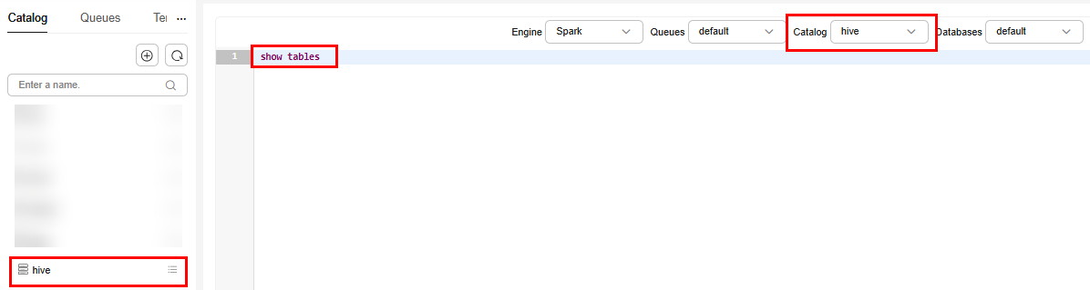

- Log in to the DLI management console.
- In the navigation pane on the left, choose SQL Editor.
- On the SQL editor page, select a data catalog under Catalog.
- Click
to create a data catalog. - In the Create Catalog dialog box, set data catalog parameters.

Step 4: Authorize to Use LakeFormation Resources

Step 5: Use LakeFormation Metadata During DLI Job Development
After connecting DLI to the default LakeFormation instance and authorizing access to LakeFormation resources, you can use LakeFormation metadata during DLI job development.
- DLI SQL:
When running a SQL job, you can select the catalog where the SQL statement is located on the console, as shown in Figure 2, or specify catalogName in the SQL statement. catalogName is the mapping name of the data catalog on the DLI console.
