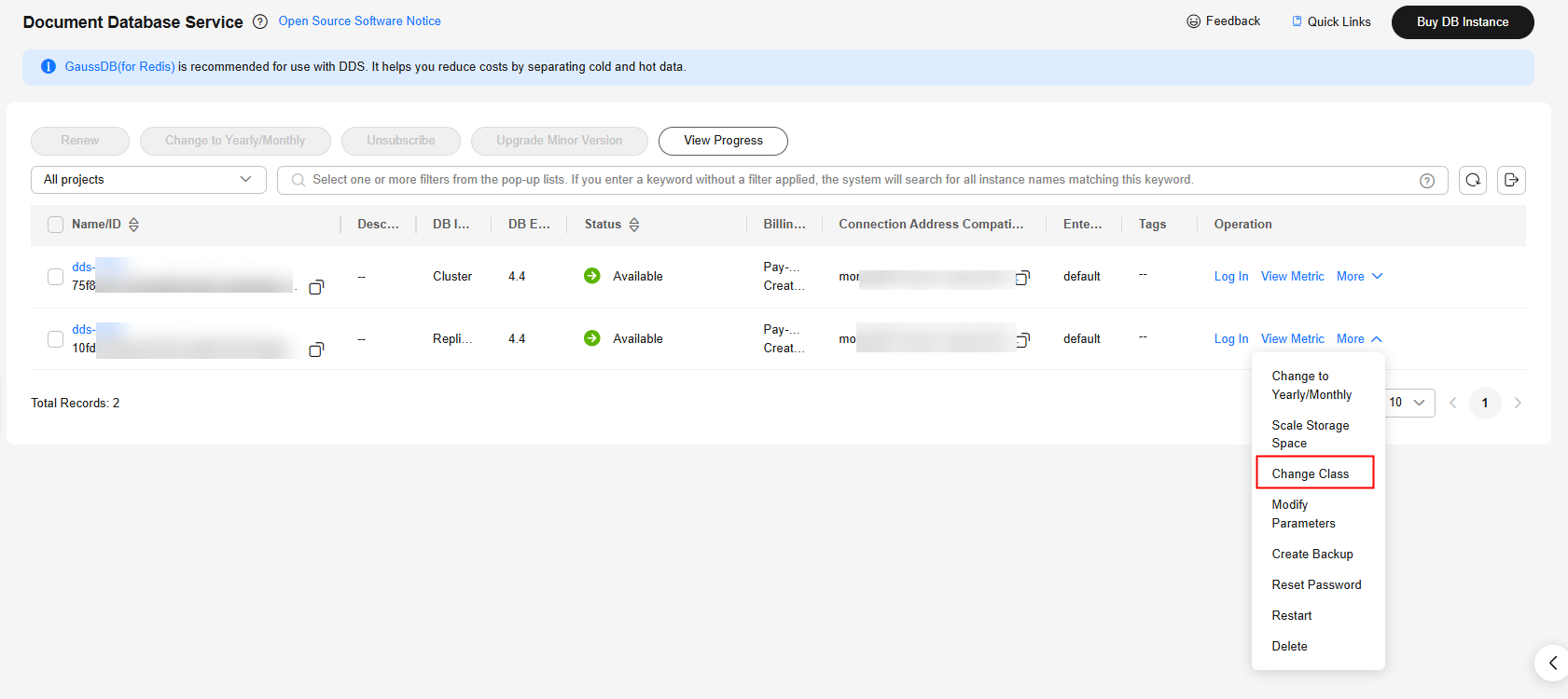

in the upper left corner of the page and choose Databases > Document Database Service. - On the Instances page, locate the replica set instance and choose More > Change Instance Class in the Operation column. Figure 1 Changing the class of a replica set instance

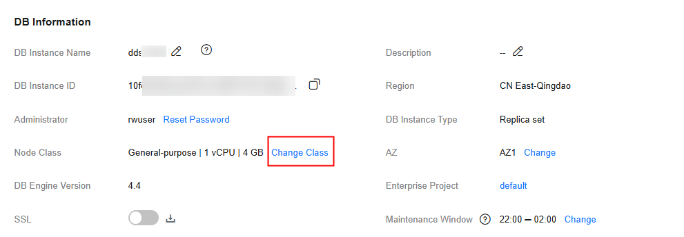

Alternatively, on the Instances page, click the name of the replica set instance. In the DB Information area on the Basic Information page, click Change Class to the right of the Node Class field.

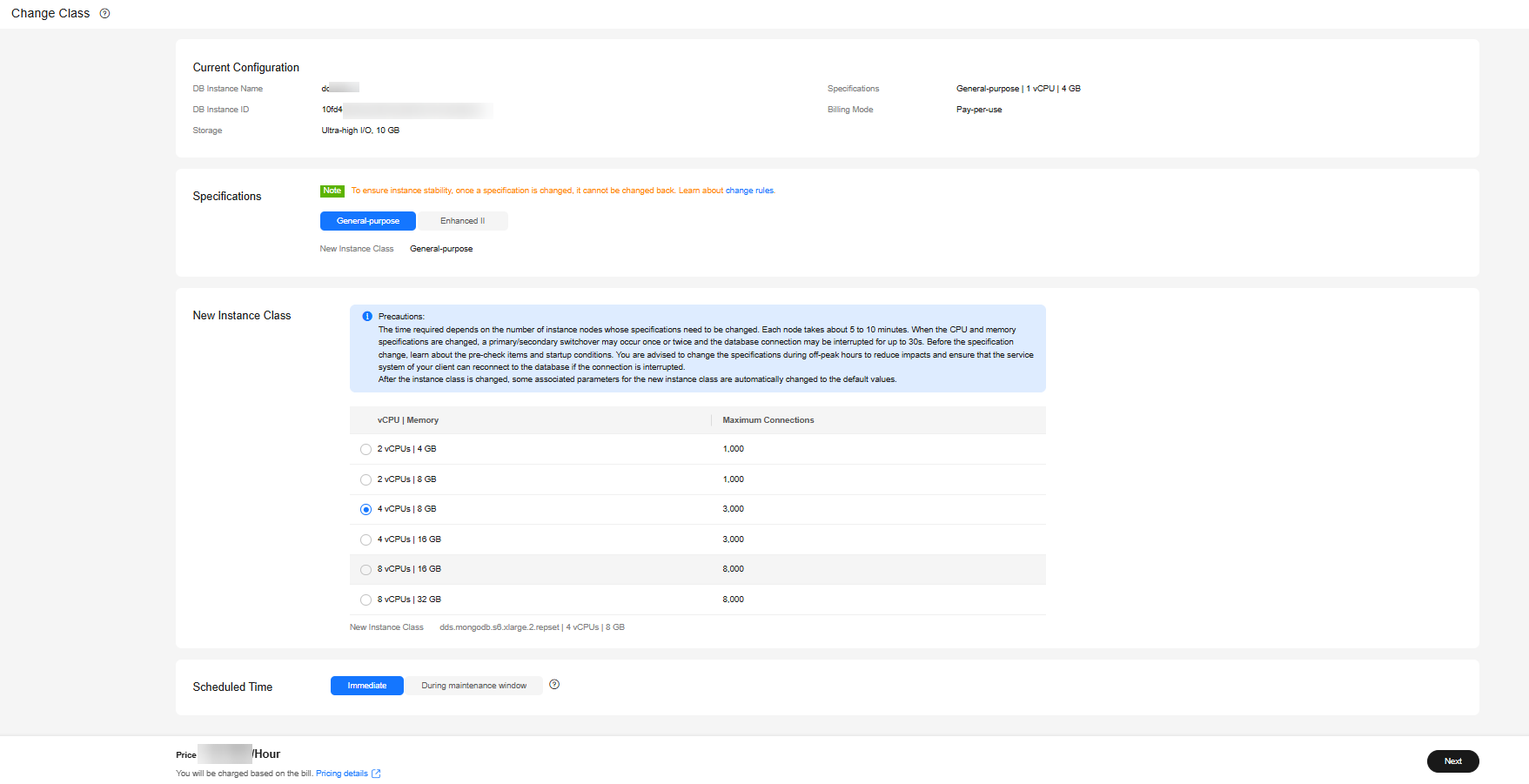

- On the displayed page, select the required specifications and new class and click Next.
The time required depends on the number of instance nodes whose class is to be changed. It takes about 5 to 10 minutes for each node. When the instance class is being changed, a primary/secondary switchover may occur once or twice and the database connection will be interrupted each time for up to 30s. Before the class change, learn about Pre-check Items for Instance Class Change. You are advised to change the class during off-peak hours to reduce impacts and ensure that the service system of your client can reconnect to the database if the connection is interrupted.
Figure 3 Changing the class of a replica set instance

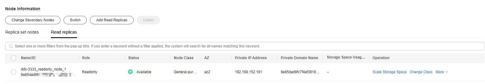

- In the Node Information area on the Basic Information page, click the Read replicas tab. Locate the read replica whose class you want to change, and click Change Instance Class in the Operation column. Figure 4 Changing the class of a read replica

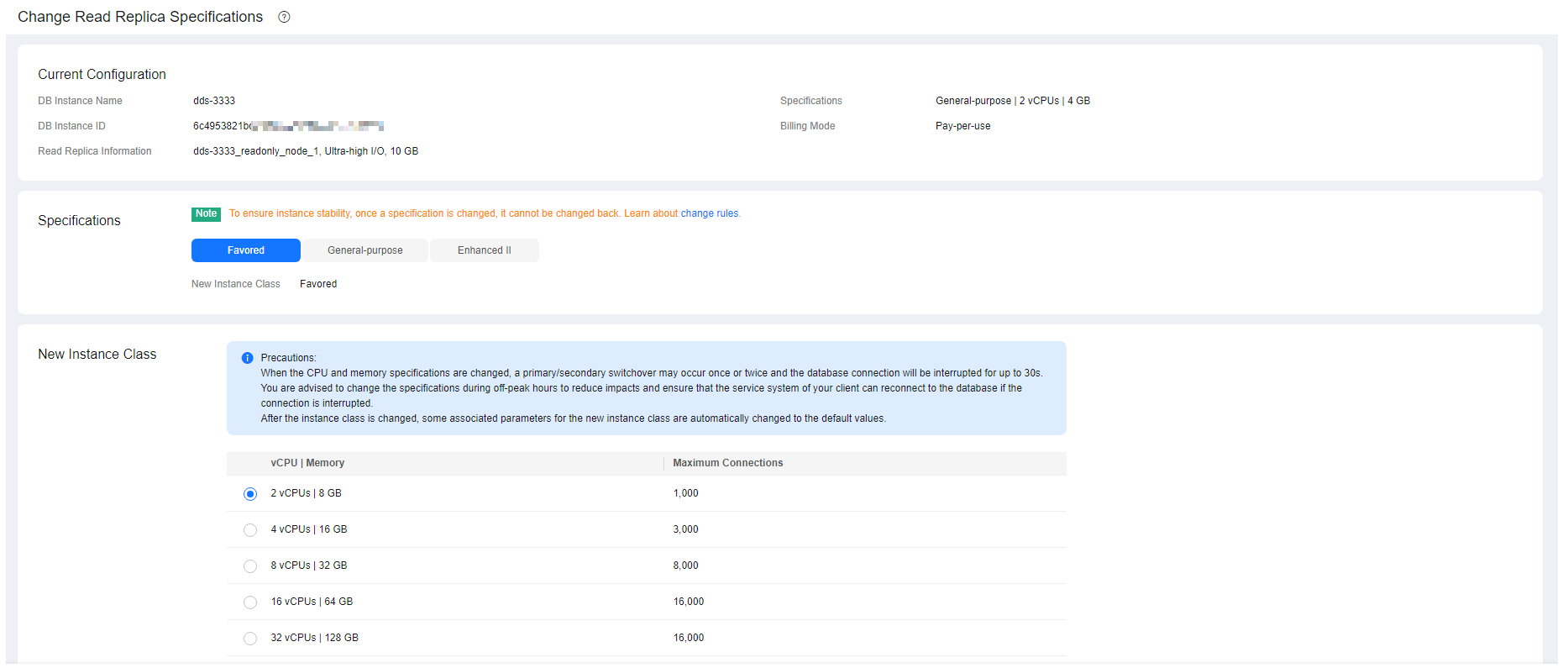

When the class of a read replica is being changed, there is a possibility that database access requests using the read replica fail. Before the class change, learn about Pre-check Items for Instance Class Change. You are advised to change the class during off-peak hours to reduce impacts and ensure that the service system of your client can reconnect to the database if the connection is interrupted.
