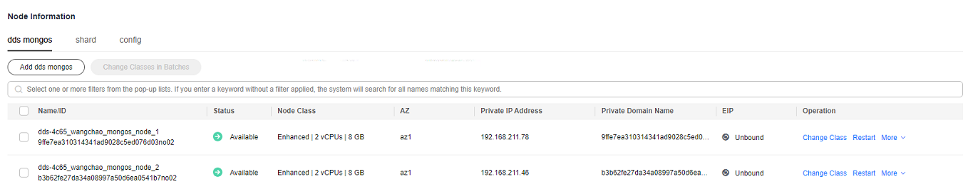

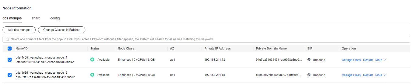

- In the Node Information area on the Basic Information page, click the dds mongos tab. You can change the class of a single dds mongos node or change the classes of multiple dds mongos nodes at a time.
- Changing the class of a dds mongos node
- In the Operation column of the dds mongos node, click Change Class. Figure 1 Changing the class of a dds mongos node

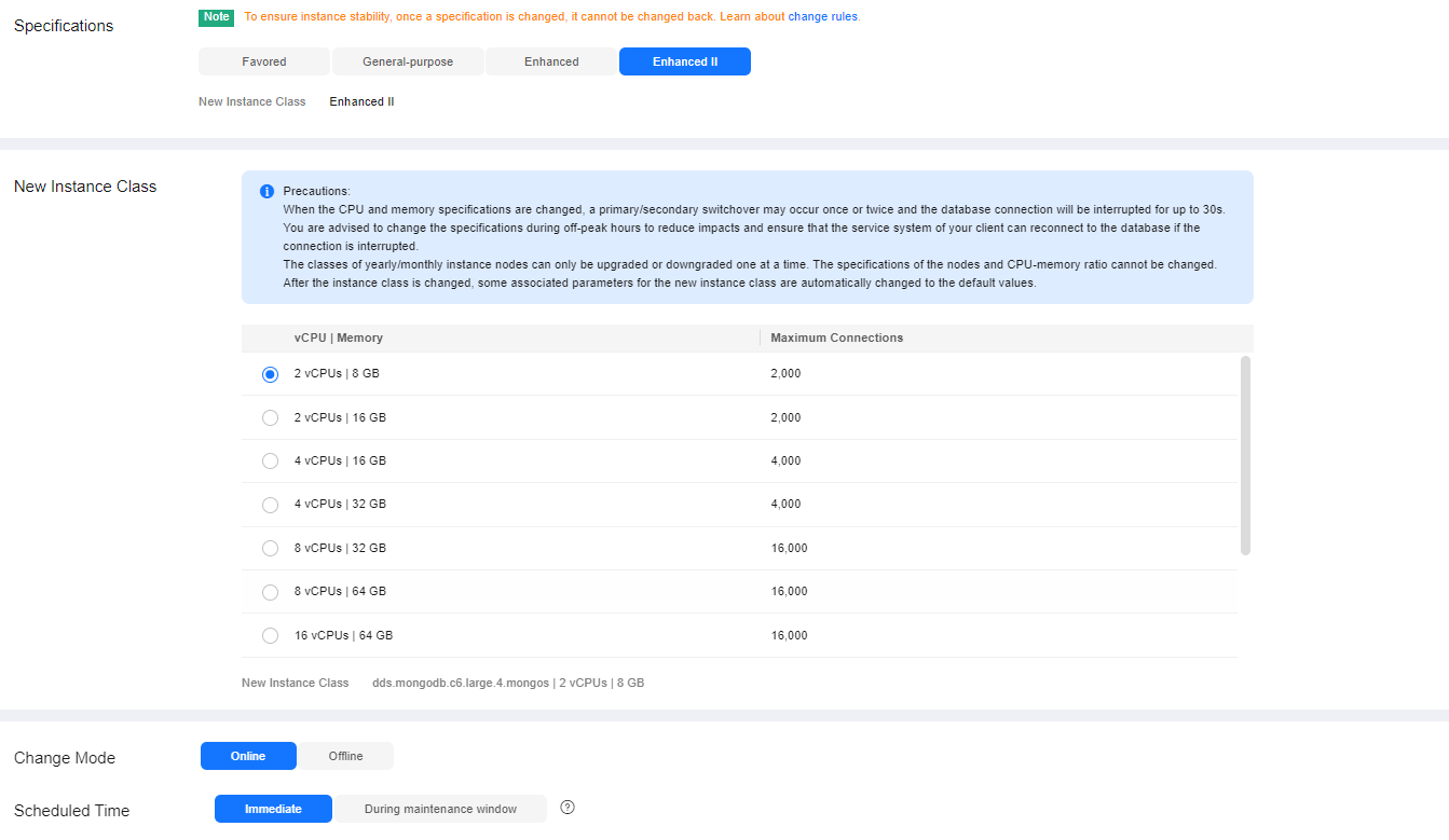

- On the displayed page, select the required specifications, new class, change mode, and scheduled time, and click Next. Figure 2 Changing dds mongos class
- Changing the classes of multiple dds mongos nodes in batches
- Select the target dds mongos nodes and click Change Classes in Batches. Figure 3 Changing the classes of multiple dds mongos nodes in batches
- On the displayed page, select the required specifications, new class, change mode, and scheduled time, and click Next. Figure 4 Changing the classes of multiple dds mongos nodes in batches
- Online change: The specifications of multiple dds mongos nodes will be changed one by one. The time required depends on the number of instance nodes whose specifications need to be changed. Each node takes about 5 to 10 minutes. You are advised to connect to a DB instance using the HA connection address and ensure that your applications support automatic reconnection.
- Offline change: The specifications of multiple dds mongos nodes will be changed concurrently and the database will be unavailable during the specification change. It takes about 5 to 10 minutes. This function is now in OBT. To use it, submit a service ticket.

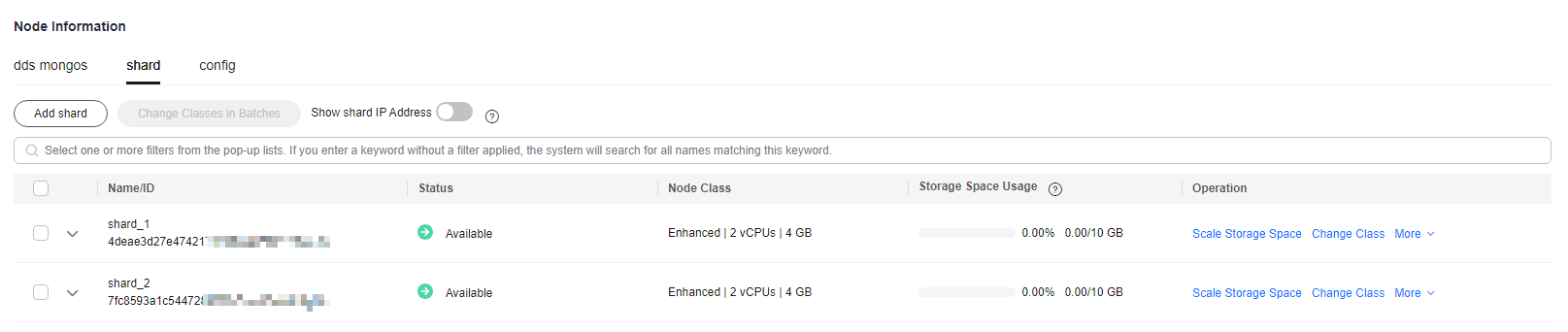

- In the Node Information area on the Basic Information page, click the shard tab. You can change the class of a single shard or change the classes of multiple shards at a time.

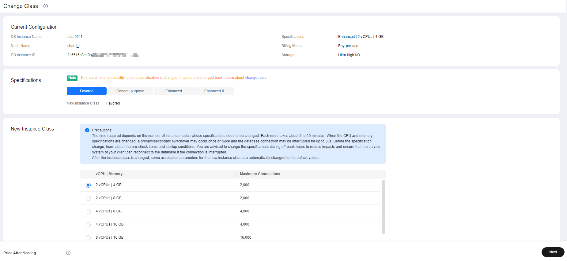

- Changing the class of a shard
- In the Operation column of the shard node, click Change Class. Figure 5 Changing the class of a shard node
- On the displayed page, select the required specifications and new class and click Next.
The time required depends on the number of instance nodes whose class is to be changed. It takes about 5 to 10 minutes for each node. When the instance class is being changed, a primary/secondary switchover may occur once or twice and the database connection will be interrupted each time for up to 30s. Before the class change, learn about Pre-check Items for Instance Class Change. You are advised to change the class during off-peak hours to reduce impacts and ensure that the service system of your client can reconnect to the database if the connection is interrupted.
Figure 6 Changing the class of a shard node

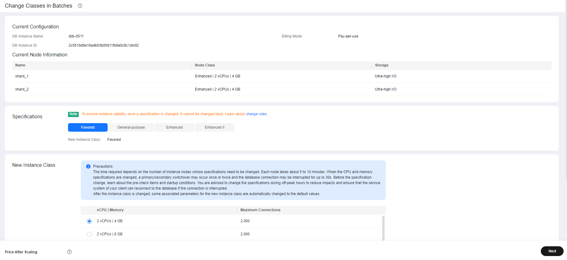

- Changing the classes of multiple shards in batches
- Select the target shards and click Change Classes in Batches.
The time required depends on the number of instance nodes whose class is to be changed. It takes about 5 to 10 minutes for each node. When the instance class is being changed, a primary/secondary switchover may occur once or twice and the database connection will be interrupted each time for up to 30s. Before the class change, learn about Pre-check Items for Instance Class Change. You are advised to change the class during off-peak hours to reduce impacts and ensure that the service system of your client can reconnect to the database if the connection is interrupted. This function is now in OBT. To use it, submit a service ticket.
Figure 7 Changing the classes of multiple shards in batches

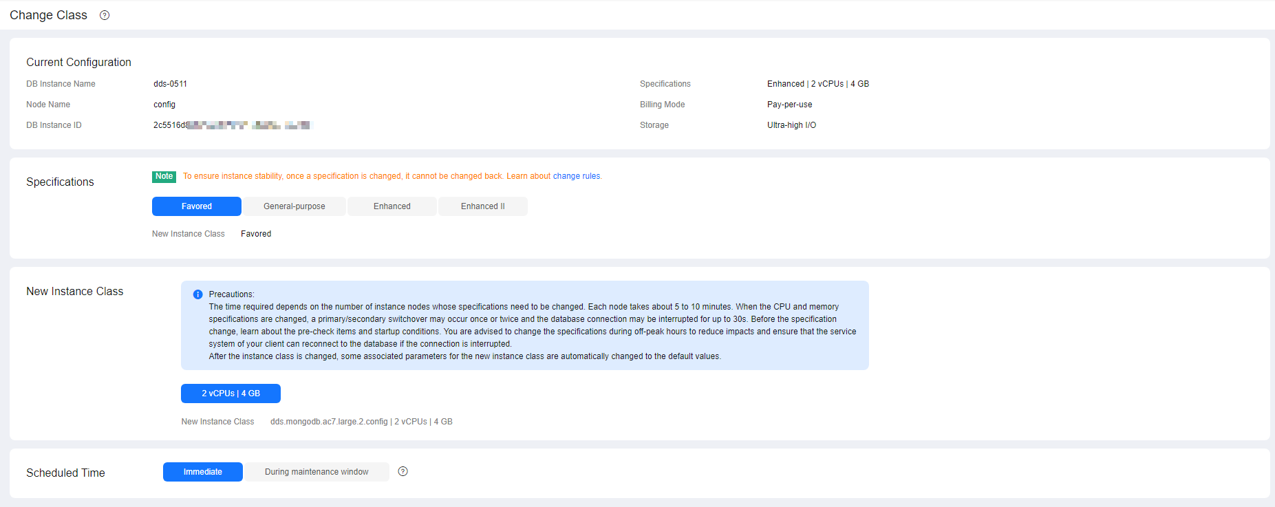

- In the Node Information area on the Basic Information page, click the config tab, locate the config node, and click Change Class in the Operation column. Figure 8 Changing config class
Figure 9 Changing config class
