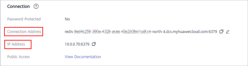

  5. Obtain the address and port in the Connection area.
    • To access Redis on a client over a private network, use Connection Address or IP Address, as shown in Figure 1. For more information, see Should I Use a Domain Name or an IP Address to Connect to a DCS Redis Instance?.
      Figure 1 Obtaining the instance addresses
      • The information next to Connection Address and IP Address is domain name:port and IP address:port of the Redis instance. The following uses the port 6379. Replace 6379 with the actual port.

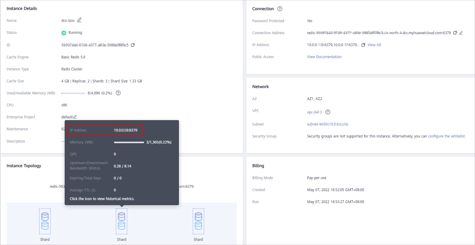

      • The IP Address field of a Redis Cluster instance provides multiple IP addresses, as shown in Figure 2. You can use any of them to connect to the instance. The CRC16(key) mod 16384 algorithm is used to compute what is the hash slot of a given key. For higher reliability, configure all IP addresses.
      • By accessing Redis using the IP Address in the Instance Topology section shown in Figure 2, you can connect to the specified shard.
        Figure 2 Obtaining the addresses for connecting to a Redis Cluster DCS instance
