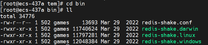

  1. Go to the redis-shake directory.
    cd bin
  2. Edit the redis-shake.conf file by providing the following information about all the masters of the source:
