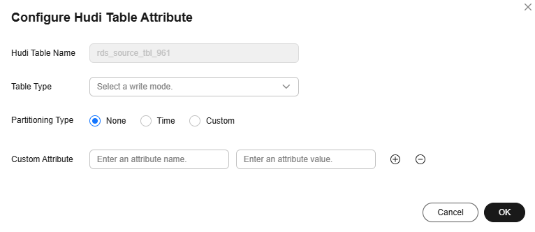

    • Edit Table Attribute
      Click Edit Table Attributes in the Operation column to configure Hudi table attributes, including the table type, partition type, and custom attributes.
      Figure 8 Configuring the Hudi table attributes
      • Table Type: Hudi table type. Select MERGE_ON_READ or COPY_ON_WRITE.
      • Partition Type: partition type of the Hudi table. Select No partition, Time, or Custom.
        • For Time, you need to specify a source field name and select a time conversion format.
          For example, you can specify the source field name src_col_1 and select a time conversion format, for example, day(yyyyMMdd), month(yyyyMM), or year(yyyy). During automatic table creation, a cdc_partition_key field is created in the Hudi table by default. The system formats the value of the source field (src_col_1) based on the configured time conversion format and writes the value to cdc_partition_key.
        • Custom partitions do not support timestamp fields. If you use timestamp fields, the job will fail.
      • Customize table attributes. Some advanced functions of a single table can be configured using parameters. For details about the parameters, see the table that lists Hudi advanced configurations.
