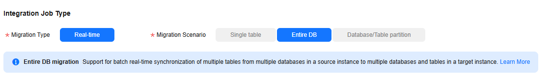

- Select a job type. The default migration type is Real-time. The migration scenario is Entire DB.Figure 2 Setting the migration job type
For details about synchronization scenarios, see Synchronization Scenarios.

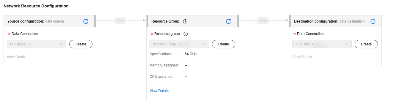

- Configure network resources. Select the created GaussDB(RDS PostgreSQL) and MRS Kafka data connections and the migration resource group for which the network connection has been configured.Figure 3 Selecting data connections and a migration resource group
If no data connection is available, click Create to go to the Manage Data Connections page of the Management Center console and click Create Data Connection to create a connection. For details, see Configuring DataArts Studio Data Connection Parameters.

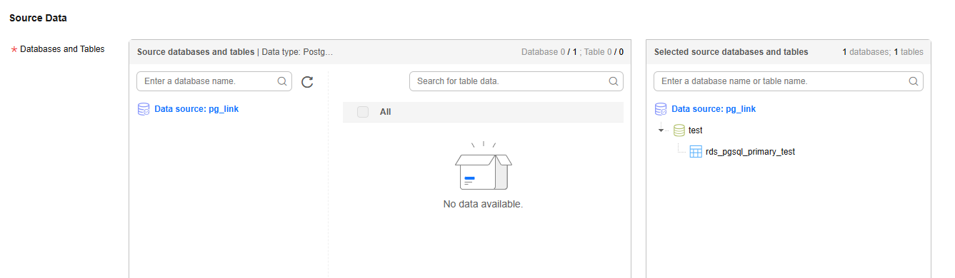

Select the databases and tables to be synchronized based on the following table.
Table 5 Selecting the databases and tables to be synchronized Synchronization Scenario
Configuration Method
Entire DB
Select the GaussDB databases and tables to be migrated.Figure 4 Selecting databases and tables
Both databases and tables can be customized. You can select one database and one table, or multiple databases and tables.

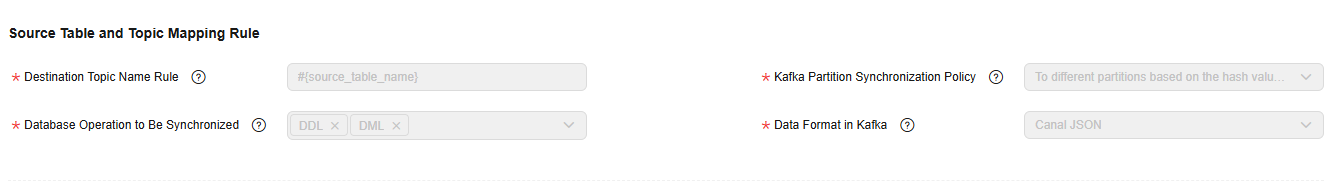

- Configure destination parameters.Figure 5 Kafka destination parameters
- Destination Topic Name Rule
Configure the rule for mapping source database tables to destination Kafka topics. You can specify a fixed topic or use built-in variables to synchronize data from source tables to destination topics.
The following built-in variables are available:
- Source database name: #{source_db_name}
- Source table name: #{source_table_name}
- Kafka Partition Synchronization Policy
The following three policies are available for synchronizing source data to specified partitions of destination Kafka topics:
- To Partition 0
- To different partitions based on the hash values of database names/table names
- To different partitions based on the hash values of table primary keys
If the source has no primary key, data is synchronized to partition 0 at the destination by default.
- Partitions of New Topic
If the destination Kafka does not have the corresponding topic, the topic automatically created by DataArts Migration has three partitions.
- Destination Kafka Attributes
You can set Kafka attributes and add the properties. prefix. The job will automatically remove the prefix and transfer the attributes to the Kafka client. For details about the parameters, see the configuration descriptions in the Kafka documentation.

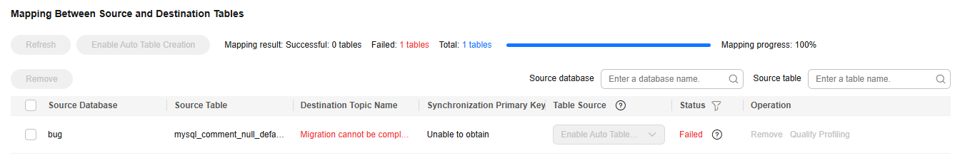

- Update the mapping between the source table and destination table and check whether the mapping is correct.You can change the names of mapped destination topics as needed. You can map one source topic to one destination topic or map multiple source topics to one destination topic.Figure 7 Mapping between source and destination tables

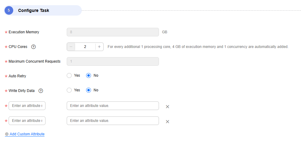

- Configure task parameters.
Table 7 Task parameters Parameter
Description
Default Value
Execution Memory
Memory allocated for job execution, which automatically changes with the number of CPU cores
8GB
CPU Cores
Value range: 2 to 32
For each CPU core added, 4 GB execution memory and one concurrency are automatically added.
2
Maximum Concurrent Requests
Maximum number of jobs that can be concurrently executed. This parameter does not need to be configured and automatically changes with the number of CPU cores.
Adding custom attributes
You can add custom attributes to modify some job parameters and enable some advanced functions. For details, see Job Performance Optimization.

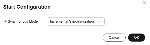

After submitting the job, click Start on the job development page. In the displayed dialog box, set required parameters and click OK.
Figure 9 Starting the job
Table 8 Parameters for starting the job Parameter
Description
Synchronous Mode
- Incremental Synchronization: Incremental data synchronization starts from a specified time point.
- Full and incremental synchronization: All data is synchronized first, and then incremental data is synchronized in real time.
