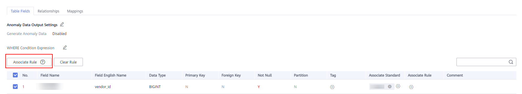

- In the Table Field area, select a field that you want to associate a quality rule with and click Associate Rule.Figure 2 Associating Quality Rules

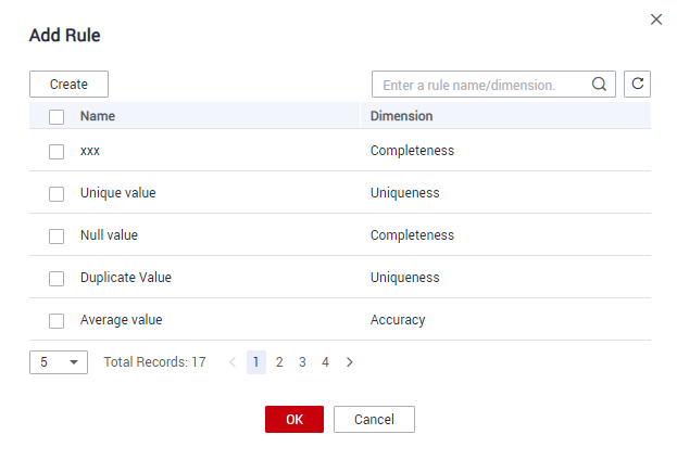

The Add Rule dialog box lists all default quality rules supported by DataArts Quality. Select a rule and click OK. If these quality rules cannot meet your requirements, you can customize one. In the Add Rule dialog box, click Create to navigate to DataArts Quality and create a rule on the page displayed. See Creating a Data Quality Rule.
Figure 4 Add Rule dialog box

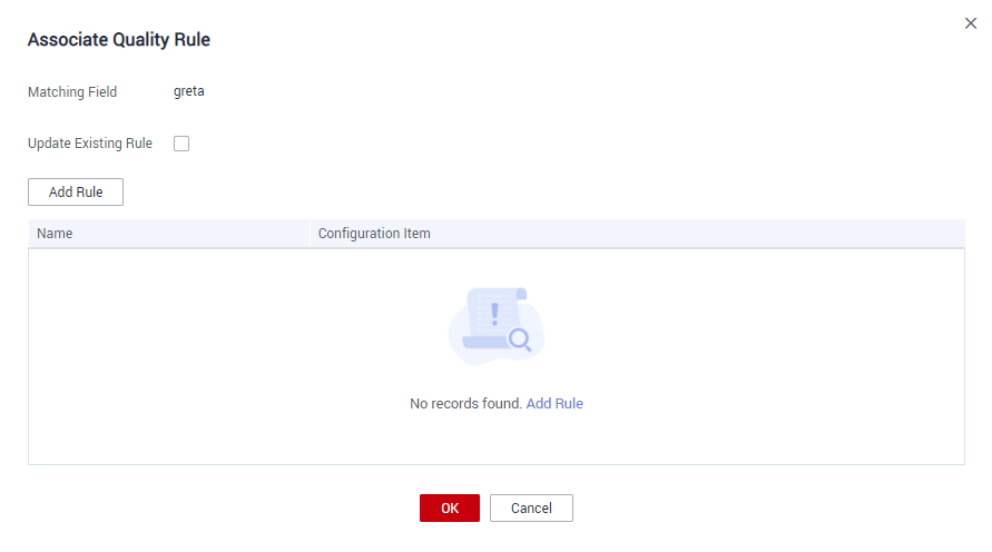

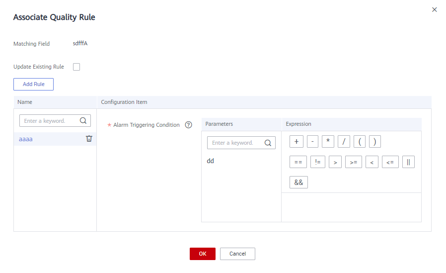

After a rule is added, the Associate Quality Rule dialog box is displayed. Select a rule from the rule name list, set Alarm Condition, and click OK.
- In the Alarm Condition text box, enter an expression. When a quality job is running, the system calculates the result of the alarm condition expression and determines whether to trigger the alarm based on the result of the expression. If the expression result is true, the alarm will be triggered. Otherwise, no quality alarm will be triggered.
- An alarm condition expression consists of alarm parameters and logical operators.
The alarm parameters of each rule are displayed as buttons. If you click these buttons, the alarm conditions are expressed in the sequence of alarm parameters, such as ${1}, ${2}, and ${3}. The variable names indicate the alarm parameters. In other words, when setting Alarm Condition, use the variable ${1} to represent the first alarm parameter, ${2} to represent the second alarm parameter, and so on.
Figure 5 Setting an alarm triggering condition

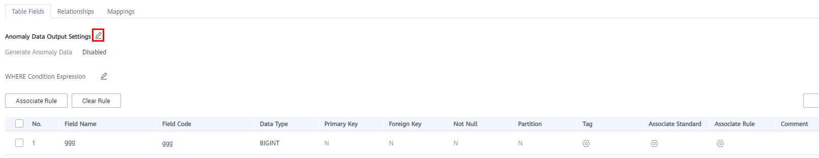

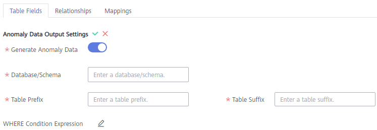

- (Optional) If you want to store anomaly data that does not comply with the preset rules in the exception table, enable Anomaly Data Output Settings.Figure 6 Enabling Anomaly Data Output Settings
Click the pen icon next to Anomaly Data Output Settings and enable Generate Anomaly Data. The anomaly data will be stored in the specified database based on the settings.
Figure 7 Anomaly Data Output Settings
The parameters are as follows:- Database/Schema: database or schema that stores anomaly data
- Table Prefix: prefix of the table that stores anomaly data
- Table Suffix: suffix of the table that stores anomaly data
Click

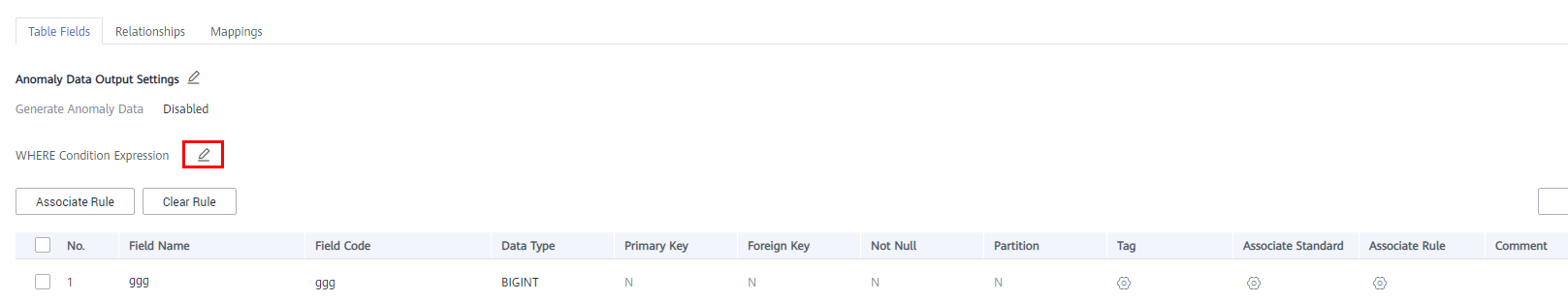

to save the settings. - (Optional) By default, the quality rule applies to the entire table. If you want to query data in specified partitions, set the where condition.Figure 8 Where condition

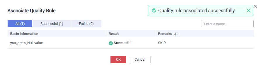

- View the association result. If the association is successful, click OK. If the association fails, find the failure cause, correct it, and associate the quality rule again.Figure 9 Association results

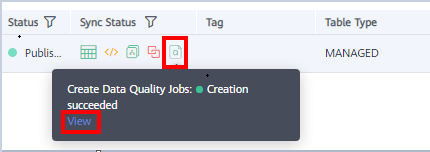

- Go back to the ER model list, locate the table that you just associated with a quality rule. In the Sync Status column, move your pointer to
and click View.Figure 10 Quality job sync status

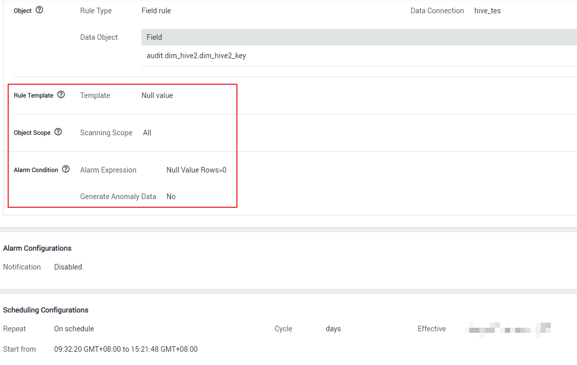

- On the page displayed, click the Rule Configurations tab to view the rule you just added.Figure 11 Quality rules

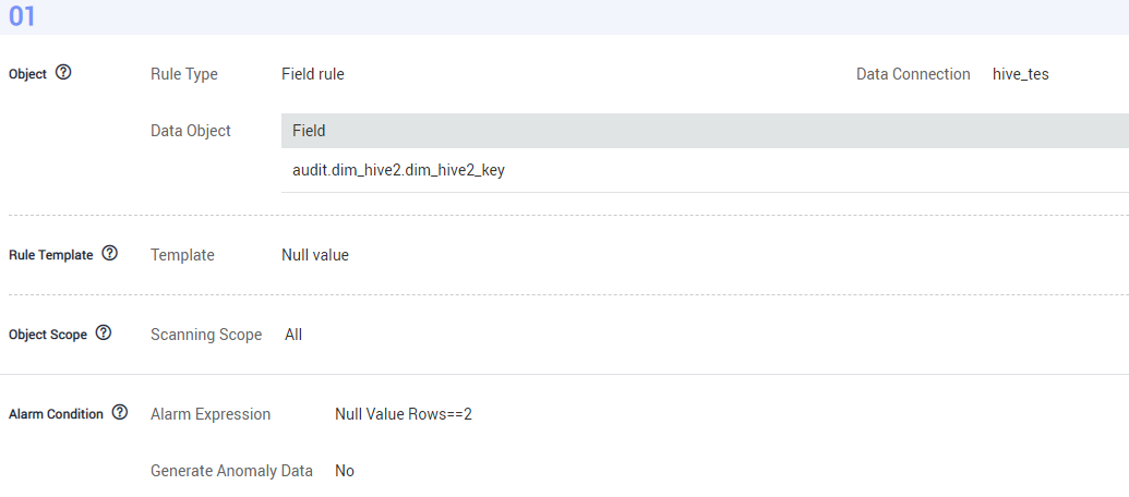

If a table is associated with a data standard when it is created, the corresponding quality rule is generated after the table is published. You can also view the rule on the Quality Jobs page.
The following provides an example of the quality rule generated based on the data standard associated with a field:
Figure 12 Quality rule associated with a field

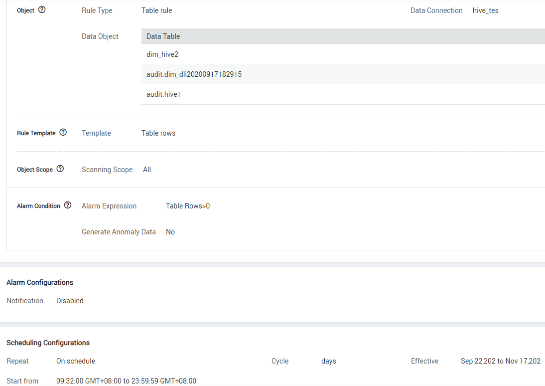

The following provides an example of the quality rule generated based on the data standard associated with a lookup table:
Figure 13 Quality rules for data standards
