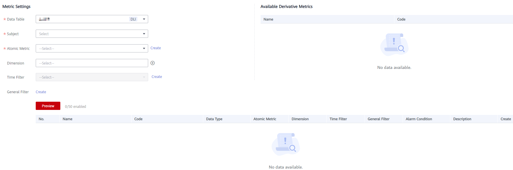

  4. On the page displayed, set the parameters.
    Figure 1 Creating a derivative metric
    Table 1 Parameters for creating a derivative metric
    Parameter
    Description
    *Data Table
    Select an asset table from the drop-down list box.
    *Subject
    Subject information.
    *Atomic Metric
    Select an atomic metric.
    Dimension
    Select one or more dimensions from the drop-down list box. Only the attributes in the fact table associated with the atomic metrics can be selected.
    Time Filter
    Select the required time filter from the drop-down list and select the associated field. Some time filters are preconfigured in the system. If the available time filters cannot meet the requirements, customize one. See Creating Time Filters for details.
    General Filter
    To set general filters, click Create. It must start with a letter. Only letters, digits, and underscores (_) are allowed.
    In the General Filter area shown in Figure 2, set the parameters as follows:
    • Name specifies the name of a general filter.
    • Under Add Condition (and), you can select And condition or Or condition to add a condition. After you specify the condition, select a field from the field drop-down list and set the parameters as prompted. You can add multiple conditions.
      If the selected field is of the string type (for example, string or varchar) and the condition is set to in or not in, data can be imported from a lookup table. Click From lookup tables, set lookup tables and lookup table field, and click OK. A maximum of 50 fields can be imported from a lookup table.
      You can click to delete unwanted conditions.
    • Under Add Formula (and), you can select And formula or OR formula to add a formula. Click Edit Formula if needed. In the dialog box displayed, select the required functions and fields and set the expression.
      You can click to delete unwanted formulas.
    Figure 2 Setting a general filter

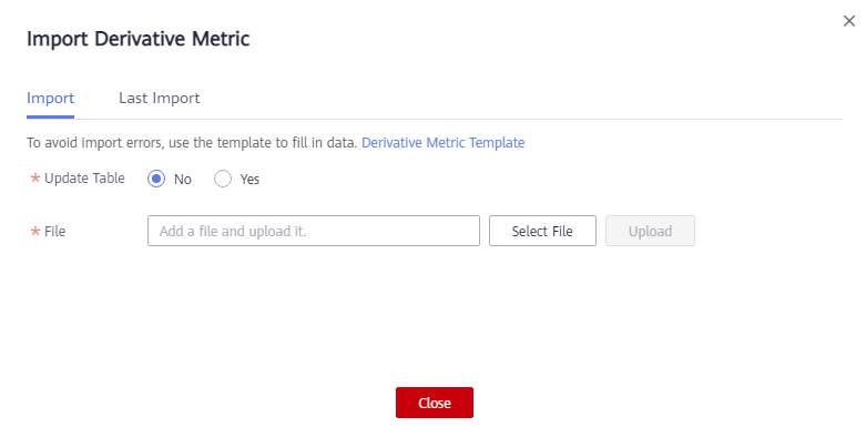

  10. Import derivative metrics.
    You can import derivative metrics to the system quickly.
    1. Above the summary table list, choose More > Import.
      Figure 4 Importing derivative metrics
    2. Download the derivative metric template, and edit and save it.
    3. Choose whether to update existing data.
      If a code in the template already exists in the system, the data is considered duplicate.
      • No: If the data to be imported already exists in the system, the existing data in the system will not be replaced.
      • Yes: If the data to be imported already exists in the system:
        • If the existing data in the system is in draft state, the data will be replaced and new draft data will be generated.
        • If the existing data in the system is in published state, expanded data will be generated.
    4. Click Select File and select the edited template to import.
    5. Click Upload. When the template is uploaded, the Last Import page is displayed. You can view the imported data.
    6. Click Close.
