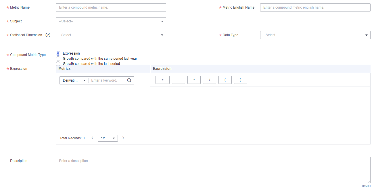

  4. On the page displayed, set the parameters.
    Figure 1 Creating a compound metric
    Table 1 Parameters for creating a compound metric
    Parameter
    Description
    *Metric Name
    Newline characters and the following characters are not allowed: \ < > % " ' ;
    *Metric Code
    Metric code names must start with letters. Only letters, numbers, and underscores (_) are allowed.
    *Subject
    Subject information. Select a subject.
    *Statistical Dimension
    The available options are those configured on the Derivative Metrics page.
    *Data Type
    Select a data type for the compound metric.
    *Compound Metric Type
    The following options are available:
    • Expression
    • Growth compared with the same period last year
    • Growth compared with the last period
    Description
    A description of the compound metric to create. Up to 600 characters are supported.
    Expression
    *Expression
    Select the required derivative metrics or compound metrics and set the expression as required.

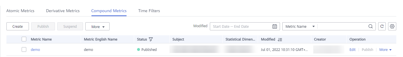

  1. On the DataArts Architecture page, choose Metrics > Technical Metrics in the left navigation pane. On the displayed page, click the Compound Metrics tab.
    Figure 2 Compound metrics
  2. In the compound metric list, select the target metric and click Edit on the right.
