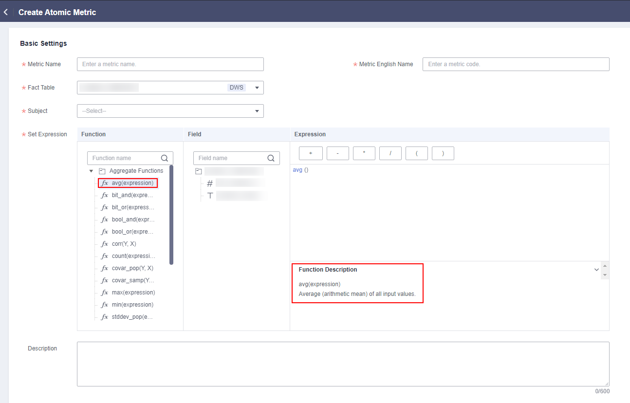

- On the Create Atomic Metric page, set the parameters described in Table 1 and click Publish.
Figure 1 Creating an atomic metric
Table 1 Parameters for creating an atomic metric Parameter
Description
*Metric Name
Newline characters and the following characters are not allowed: \ < > % " ' ;
*Metric Code
Metric codes must start with letters. Only letters, numbers, and underscores (_) are allowed.
*Data Table
Select a published fact table from the drop-down list box. If there are many tables, you can enter a table name in the text box to search for the desired fact table. If no fact table is available, create one. See Creating and Publishing a Fact Table.
*Subject
The subject to which the atomic metric belongs. After a fact table is selected, the information about the subject to which the fact table belongs is automatically displayed. You can also click Select to select a subject.
*Set Expression
Select the required functions and fields and set the expression. For details about the functions, see Functions.
