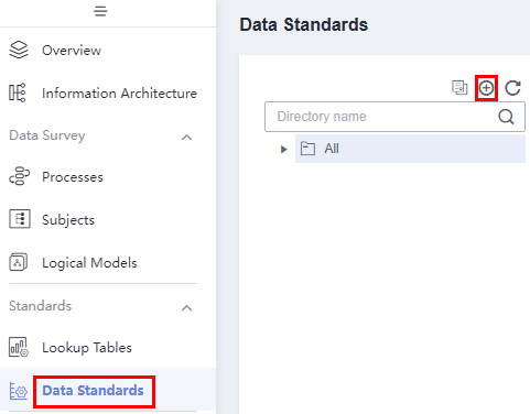

  1. On the DataArts Architecture page, choose Standards > Data Standards in the left navigation pane.
  2. When you access the Data Standards page for the first time, the page where you can customize a standard template is displayed. Select the required options for Optional, add custom items, and click Update.
    After saving the template settings, you can modify it on the Standard Templates tab page of Configuration Center. For details, see Standard Templates. When creating a data standard, you must set the selected options in the template.
  3. On the Data Standards page, select a directory and click to create a directory under the selected one. When creating a directory for the first time, you can create a directory under the root directory.
    Figure 1 Data Standards page

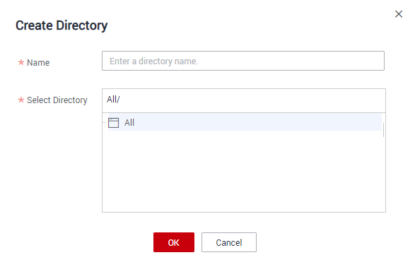

  4. In the dialog box displayed, set the parameters and click OK.
    Figure 2 Create Directory dialog page
    Table 1 Parameters for creating directories
    Parameter
    Description
    *Name
    The following characters are not allowed: / \ < > .
    *Select Directory
    Select an existing directory, and create a subdirectory under it.
    Click to refresh the directories.
    Click to refresh the directories and synchronize subject directories to data standard directories.
    • Before synchronizing subject directories, check whether there are released subjects in the current workspace. If there are no released subjects, an error will occur during the synchronization.
    • A maximum of five levels of subject directories can be synchronized to data standard directories. Subject directories beyond this range will not be synchronized. The number of directories after the synchronization cannot exceed the upper limit (generally 500). Otherwise, an error will occur and the synchronization will be canceled. Before a synchronization, the system checks for and deletes empty data standard directories. These directories and their subdirectories do not contain any data standard.
    • The synchronized subject directories are displayed as L1 to L5 icons, and the existing data standard directories are displayed as their original icons.

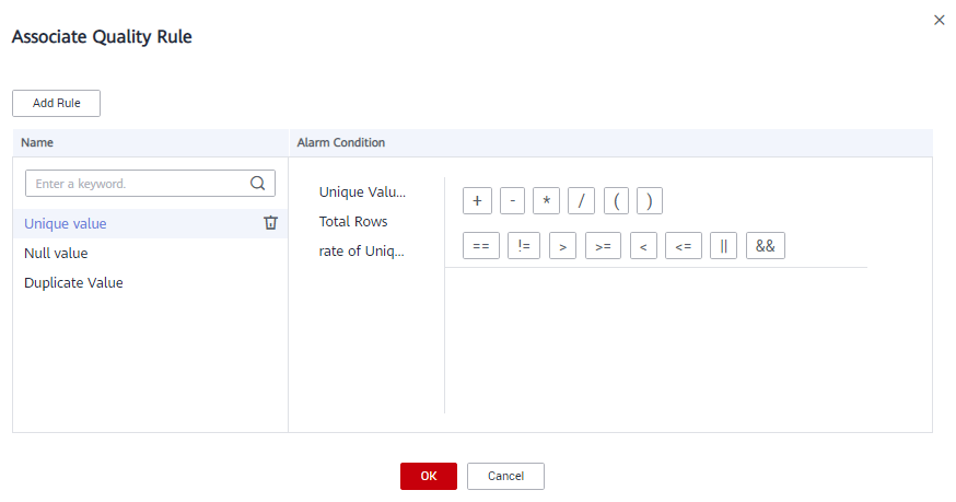

    Quality Rule
    This parameter is available if Quality rule is selected on the Standard Templates tab page on the Configuration Center page. You can associate a system quality rule or a quality rule you have created.
    Click . In the dialog box displayed, click Add Rule.
    For example, add a rule named Unique value, select the rule, click OK, enter an alarm condition expression in the Alarm Condition text box, add other rules in the same way, and click OK.
    An alarm condition expression consists of alarm parameters and logical operators. When a quality job is running, the system calculates the result of the alarm condition expression and determines whether to trigger the alarm based on the result of the expression. If the expression result is true, the alarm will be triggered. Otherwise, no quality alarm will be triggered.
    The alarm parameters of each data quality rule are listed as buttons.
    Figure 3 Associate Quality Rule dialog box

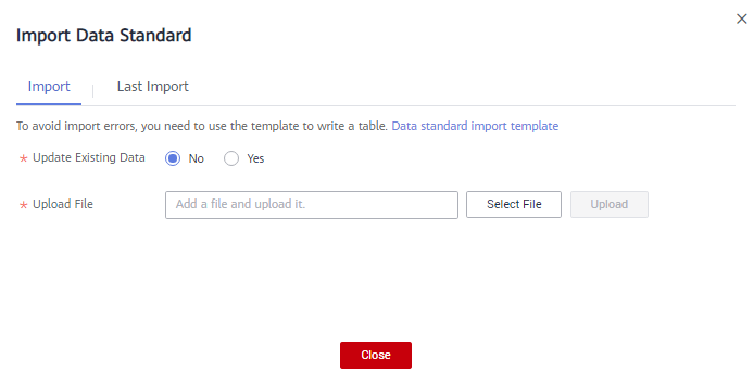

  2. In the directory structure of data standards, select a directory and choose More > Import.
    Figure 4 Import Data Standard dialog box
  3. In the Import Data Standard dialog box, determine whether to update the existing data. Existing data is uniquely identified by a standard code. If a standard code in the import template already exists in the current workspace, the system considers that the group of data to which the standard code in the import template belongs already exists.
  4. On the Import tab page, click Data standard import template to download the template. Open the template, set the parameters in the template based on service requirements, and save the settings.
    Table 3 and Table 4 describe the parameters required for importing a data standard. Parameters whose names start with an asterisk (*) are mandatory, and other parameters are optional.

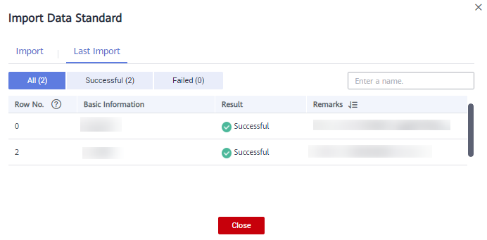

  6. In the Import Data Standard dialog box, the import result is displayed on the Last Import tab page. If the import is successful, click Close. If the import fails, you can view the failure cause, correct the template file, and upload it again.
    Figure 5 Last Import tab page

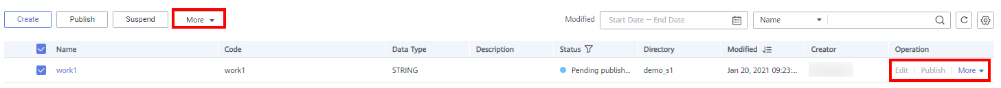

On the DataArts Architecture page, choose Standards > Data Standards in the left navigation pane. On the page displayed, you can manage data standards as required.
  • The data standards created in the public workspace can be queried in a common workspace, but the data standards created in a common workspace cannot be queried in the public workspace.
  • A common workspace has the edit permission of only the data standards and directories created in the same workspace, and can view indexes in the public workspace rather than perform any operation on the data standards and directories in the public workspace.
Figure 6 List of data standards
On the Data Standards page, you can perform the following operations:
  • Search
    Above the data standard list, select a filter such as the standard name, data type, creator, and reviewer, and click the search icon to search for data standards.
    After locating the specified data standards, you can perform the following operations:
    • Edit
    • Publish
    • Suspend
  • Import
    Choose More > Import to import a data standard. Download the template, fill in it and upload it, and click Close.
  • Export
    • Export data standards from a specified directory.
      In the data standard directory structure, select a directory and choose More > Export above the data standard list to export all data standards in the directory.
    • Export specified data standards.
      In the data standard list, select the data standards you want to export and choose More > Export above the list to export the selected data standards.
  • Delete
    Select a data standard, and choose More > Delete. A data standard in publishing review, published, or suspension review state cannot be deleted. Referenced data standards cannot be deleted as well.
  • Publish
    Select a data standard and click Publish. In the displayed dialog box, perform either of the following operations:
    • Select a reviewer. If no reviewer is available in the drop-down list, click to add one.
    • Select Auto-review.
      Auto-review is available only when the current account is in the reviewer list.
    Click OK. If a reviewer is selected, the data standard is published after the application is approved. If Auto-review is selected, the data standard will be published immediately.
