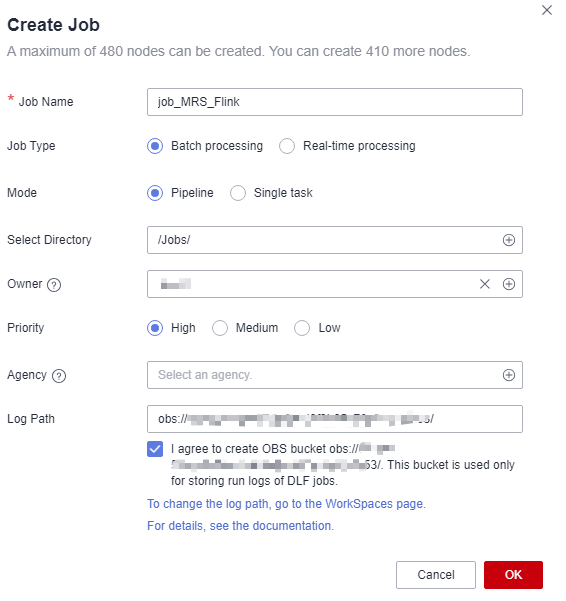

  2. Create an empty job named job_MRS_Flink.
    Figure 1 Creating a job

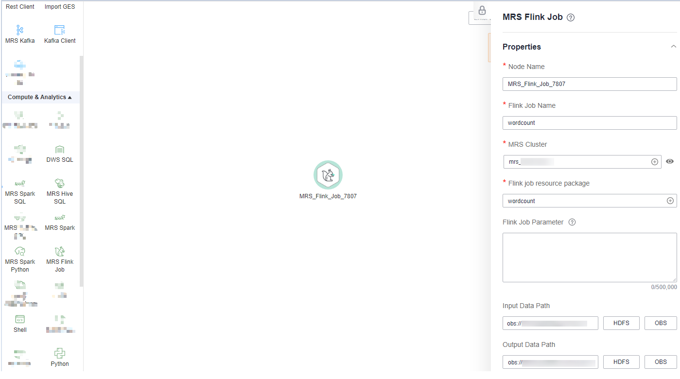

  3. Go to the job development page, drag the MRS Flink node to the canvas, and click the node to configure its properties.
    Figure 2 Configuring properties for an MRS Flink node
    Parameter descriptions:
    --Flink job name
    wordcount
    --MRS cluster name
    Select an MRS cluster.
    --Program parameter
    -c    org.apache.flink.streaming.examples.wordcount.WordCount
    --Flink job resource package
    wordcount
    --Input data path
    obs://dlf-test/lkj_test/input/word.txt
    --Output data path
    obs://dlf-test/lkj_test/output.txt
    Specifically:
    obs://dlf-test/lkj_test/input/word.txt is the directory where the wordcount.jar parameters are passed. You can pass the words to count.
    obs://dlf-test/lkj_test/output.txt is the directory where the output parameter file is stored. (If the output.txt file already exists, an error is reported.)
