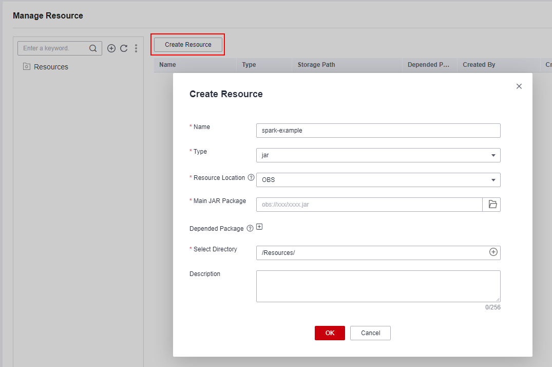

  3. In the navigation tree on the left, choose Configuration > Manage Resource. Click Create Resource and create resource spark-example on DataArts Factory and associate it with the JAR package obtained in 1.

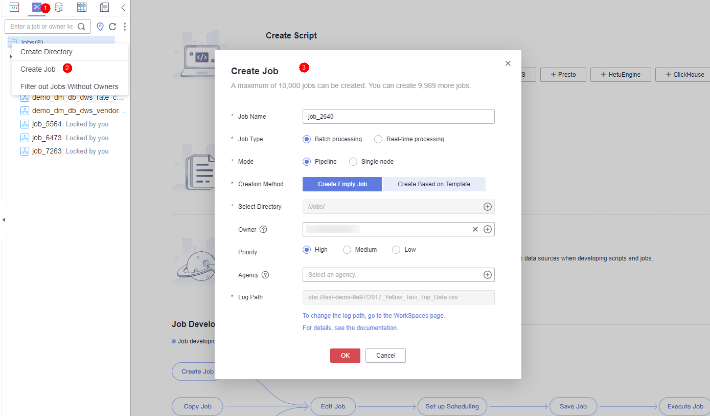

  1. Create a job named job_DLI_Spark for the DataArts Factory module.

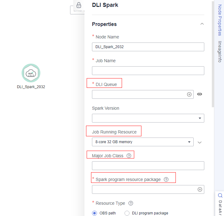

  2. Go to the job development page, drag the DLI Spark node to the canvas, and click the node to configure node properties.
    Figure 3 Configuring node properties
    Description of key properties:
    • DLI Queue: Select a DLI queue.
    • Job Running Resource: Maximum CPU and memory resources that can be used when a DLI Spark node is running.
    • Major Job Class: major class of a DLI Spark node. In this example, the major class is org.apache.spark.examples.SparkPi.
    • Spark program resource package: Select the resources created in 3.

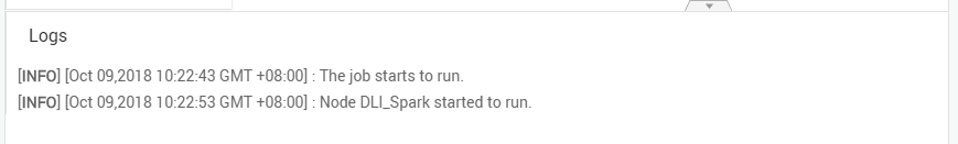

  3. After the job orchestration is complete, click to test the job.
    Figure 4 Job logs (for reference only)
  4. If no error is recorded in logs, save and submit the job.
