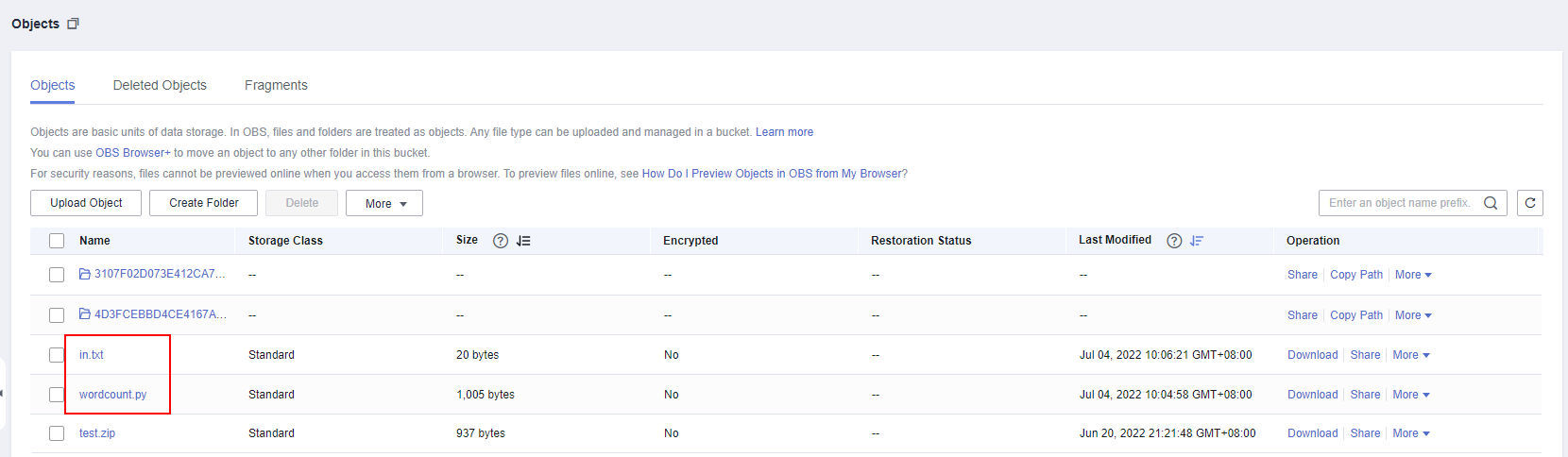

  1. Upload the script and data file to the OBS bucket.
    Figure 1 Uploading files to an OBS bucket
    In this example, upload wordcount.py and in.txt to obs://obs-tongji/python/.

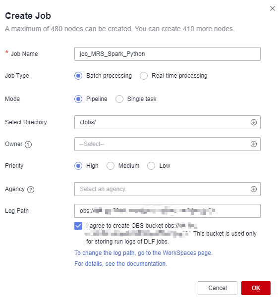

  2. Create an empty job named job_MRS_Spark_Python.
    Figure 2 Creating a job

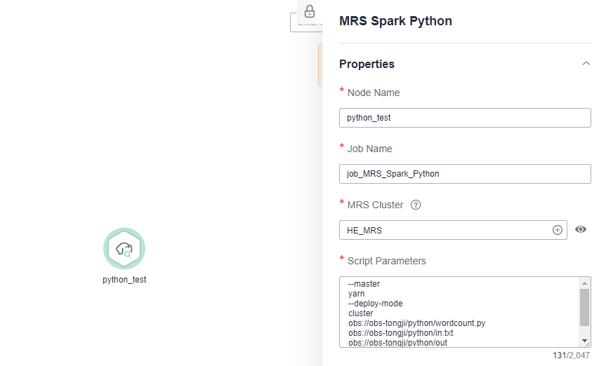

  3. Go to the job development page, drag the MRS Spark Python node to the canvas, and click the node to configure its properties.
    Figure 3 Configuring properties for an MRS Spark Python node
    Parameter descriptions:
    --master
    yarn
    --deploy-mode
    cluster
    obs://obs-tongji/python/wordcount.py
    obs://obs-tongji/python/in.txt
    obs://obs-tongji/python/out
    Specifically:
    obs://obs-tongji/python/wordcount.py is the directory where the script is stored.
    obs://obs-tongji/python/in.txt is the directory where the wordcount.py parameters are passed. You can pass the words to count.
    obs://obs-tongji/python/out is the directory where output parameters are stored. This directory will also be created in the OBS bucket automatically. If the out directory already exists in the OBS bucket, an error will occur.

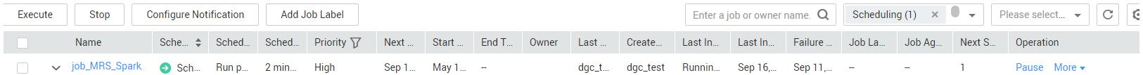

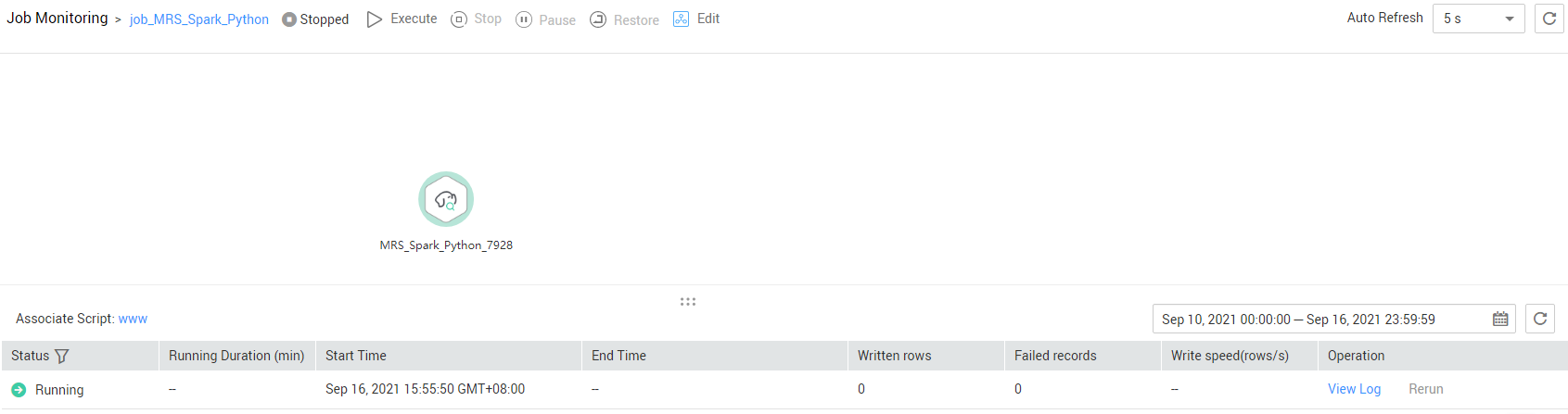

  4. Click Test to execute the script job.
  5. After the test is complete, click Submit.
  6. Choose Monitor Job in the navigation pane and view the job execution result.
    Figure 4 Viewing the job execution result

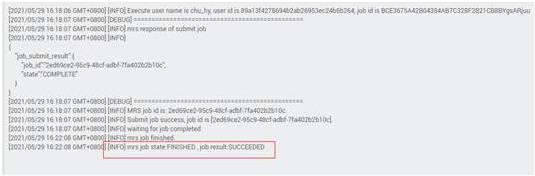

    The job log shows that the job was successfully executed.
    Figure 5 Job run logs

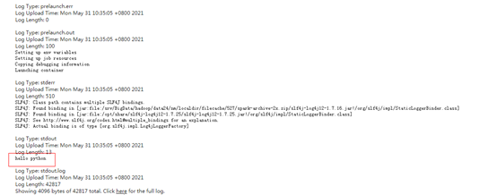

  7. Verify the log.
    Log in to MRS Manager and check that the log on YARN contains hello python.
    Figure 9 Viewing logs on YARN
