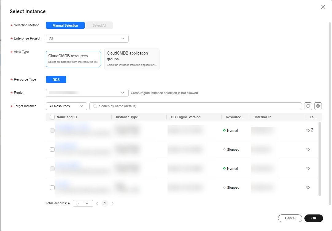

Instances that have been started cannot be selected.

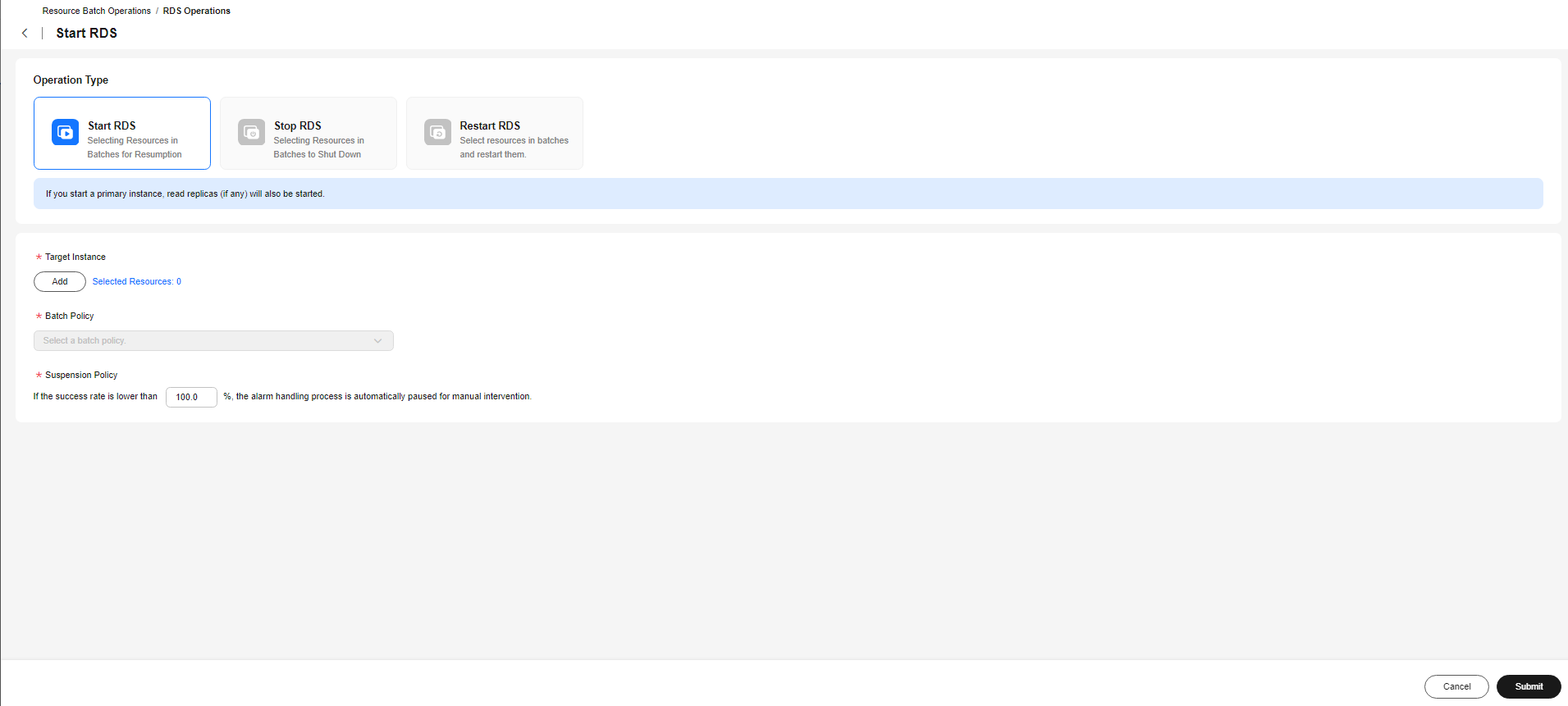

- In the navigation pane on the left, choose Resource O&M > Resource Batch Operations, and click Start RDS in RDS Operations.
- On the Start RDS page, click Add. Figure 1 Selecting instances

- Click Submit. Figure 2 Starting instances

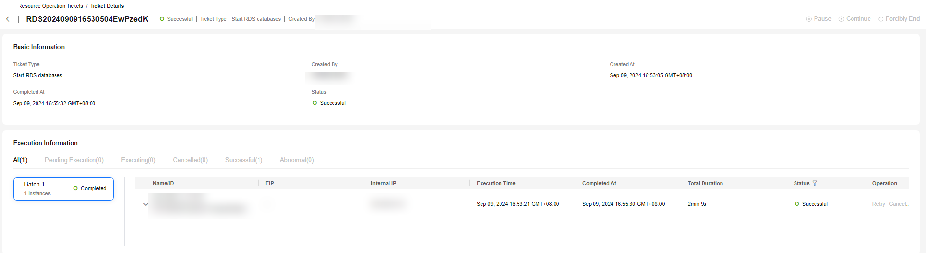

- View the execution result. Figure 3 Execution result
- If the execution result is abnormal, you can click the Retry button in the Operation column or the Batch Retry button above the list to re-execute the failed one or more tasks. You can also click the Cancel button in the Operation column or Batch Cancel button above the list to skip one or more abnormal tasks. Figure 4 Canceling or retrying batch tasks
