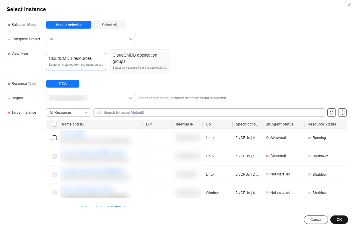

- On the Shut Down ECSs page, click Add. Figure 1 Selecting instances

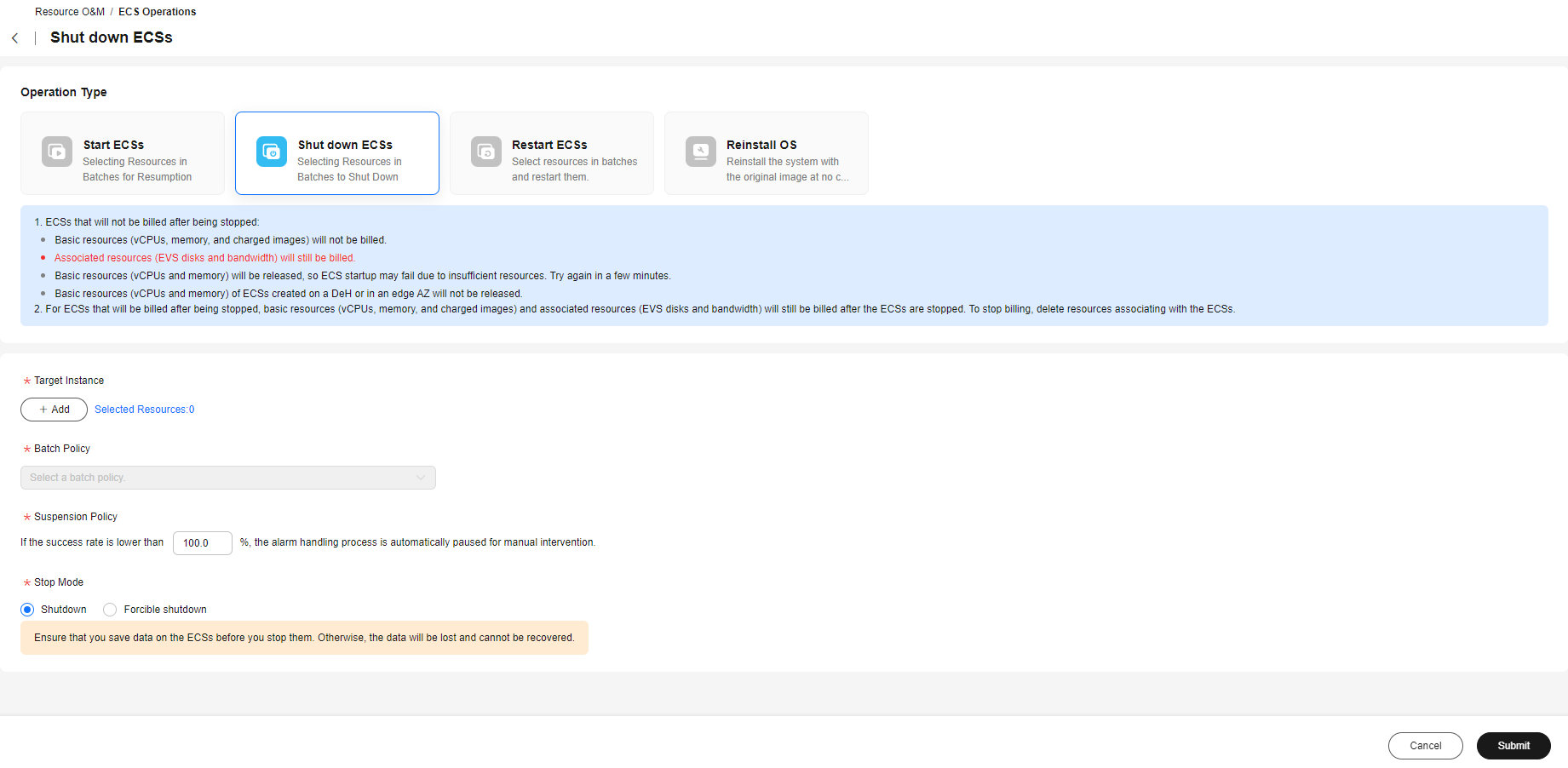

- Click Submit. Figure 2 Stopping instances

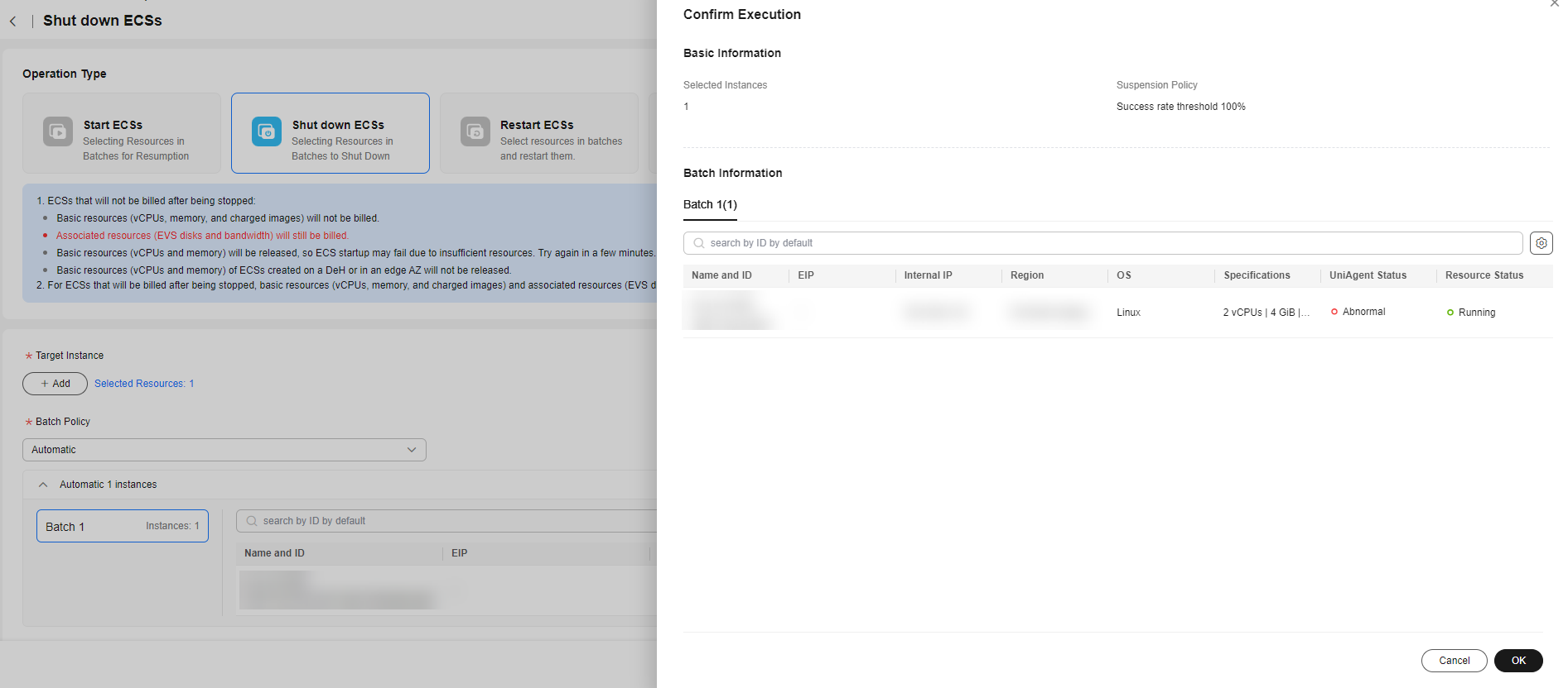

- In the Confirm Execution dialog box, click OK. Figure 3 Confirming the execution

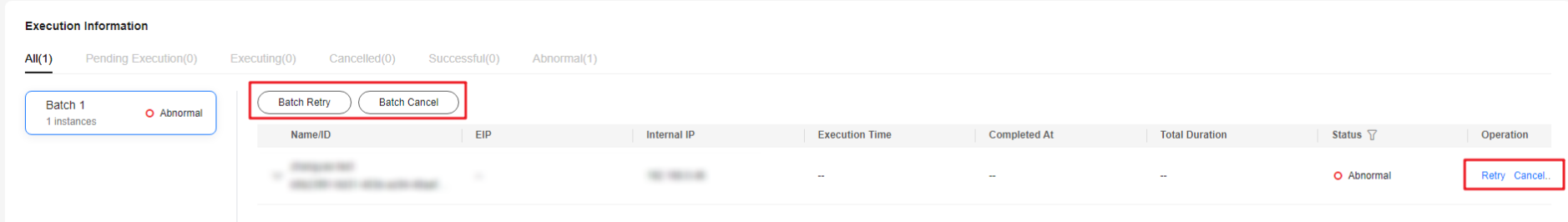

- View the execution result. Figure 4 Viewing the result
- If the execution result is abnormal, you can click the Retry button in the Operation column or the Batch Retry button above the list to re-execute the failed one or more tasks. You can also click the Cancel button in the Operation column or Batch Cancel button above the list to skip one or more abnormal tasks. Figure 5 Canceling or retrying batch tasks
