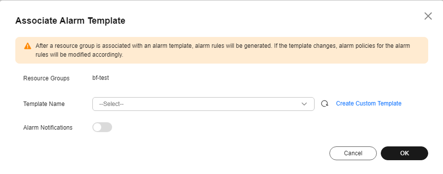

- Locate the target resource group and click Associate Alarm Template in the Operation column.
- On the displayed page, select an alarm template.
- Configure alarm notification parameters based on Table 6.
- Select an enterprise project. Figure 1 Advanced settings

- Click OK.
Associating an alarm template with a resource group triggers asynchronous operations such as creating, updating, and deleting alarm rules. This process typically lasts for 5 to 10 minutes but may take longer if there are multiple association tasks.
