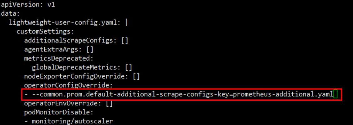

    3. After the Cloud Native Cluster Monitoring add-on is installed, set persistence parameters.
      kubectl edit cm persistent-user-config -nmonitoring
      Add - --common.prom.default-additional-scrape-configs-key=prometheus-additional.yaml under operatorConfigOverride.
      apiVersion: v1
      data:
        lightweight-user-config.yaml: |
          customSettings:
            additionalScrapeConfigs: []
            agentExtraArgs: []
            metricsDeprecated:
              globalDeprecateMetrics: []
            nodeExporterConfigOverride: []
            operatorConfigOverride:
    4. Save the change and exit. Wait for about 1 minute. You can view your custom collection task on the Grafana or AOM page.

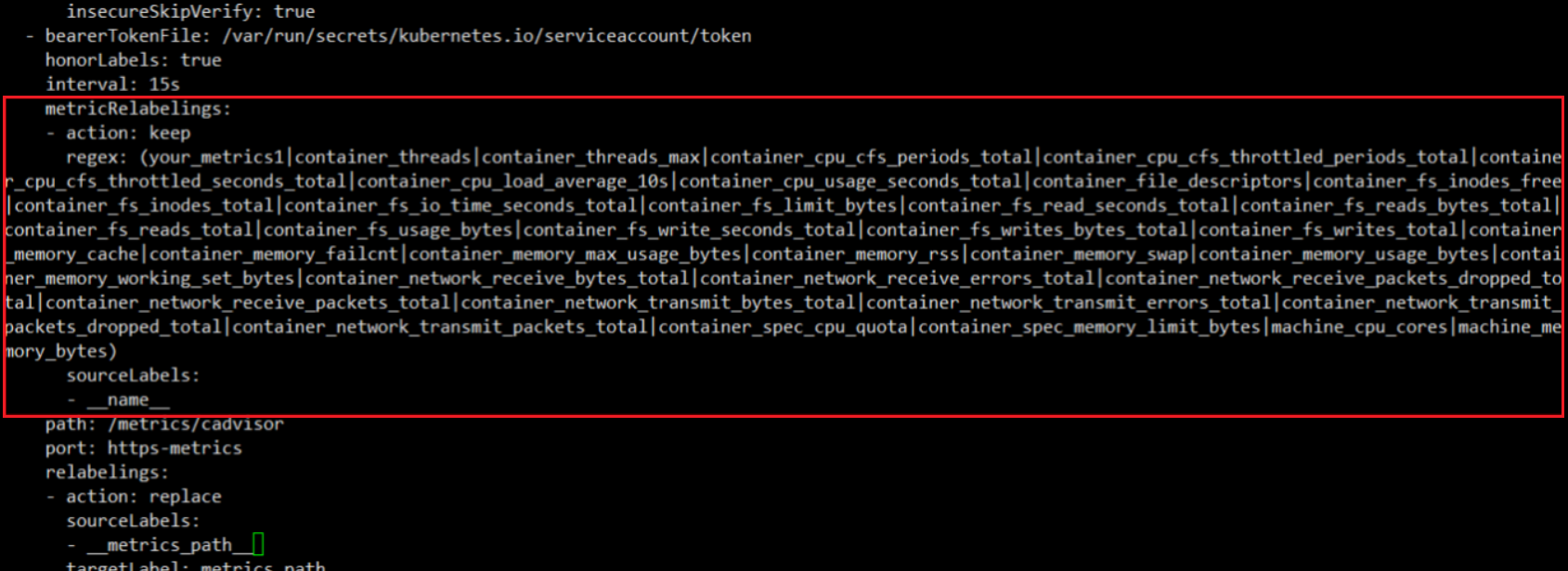

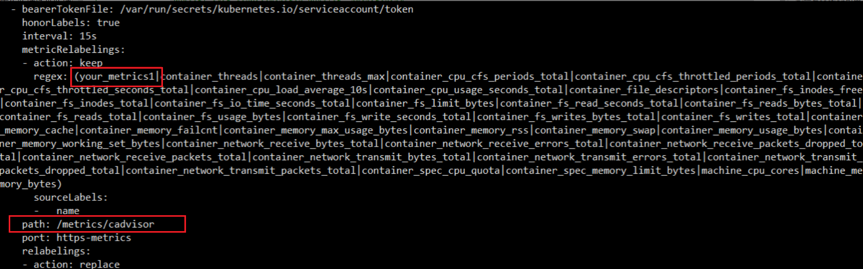

    • Extend cadiviser metrics.
      1. Run the following command to edit ServiceMonitor kubelet:
        kubectl edit servicemonitor kubelet -nmonitoring
      2. (ServiceMonitor kubelet contains two endpoints: kubelet and cadiviser.) Find the whitelist of cadiviser and add metrics as needed. (You are advised not to delete existing metrics from the whitelist. Existing metrics are free. Deleting them may affect the functions on the container intelligent analysis page.) In the following figure, the your_metrics1 metric has been added.
      3. To collect all ServiceMonitor kubelet metrics, delete the metricRelabelings content (highlighted in red in the following figure).

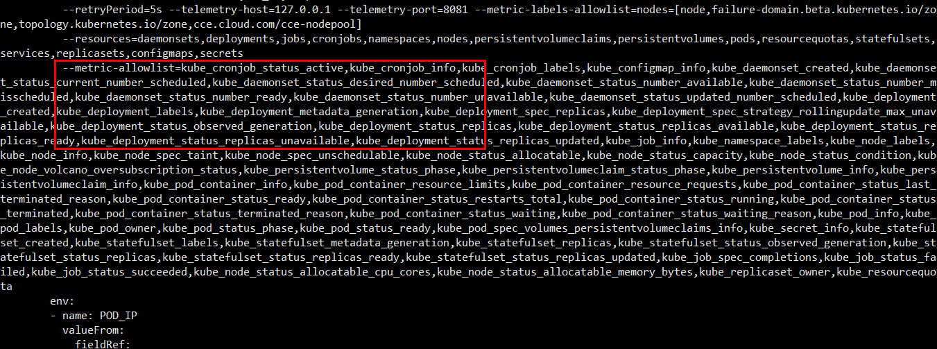

    • Extend kube-state-metrics metrics.
      1. Run the following command to edit ServiceMonitor kube-state-metrics. The procedure for extending kube-state-metrics metrics is similar to that for extending cadiviser metrics. ServiceMonitor kube-state-metrics has only one endpoint, which can be directly edited.
        kubectl edit servicemonitor kube-state-metrics -nmonitoring
      2. Modify the metric exposure content in the startup command of the kube-state-metrics workload, add the required metrics, and separate them with commas (,).
        kubectl edit deploy kube-state-metrics -nmonitoring
      3. Save the change and exit.

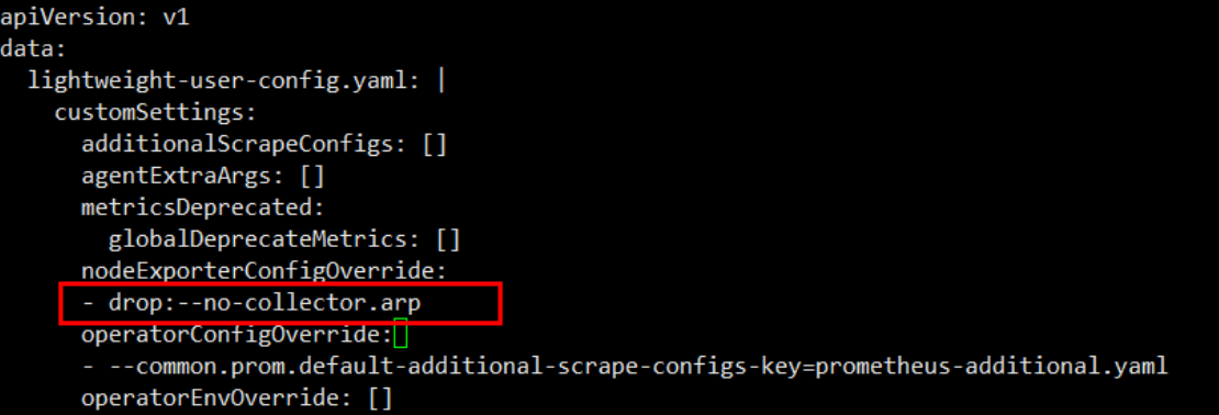

      3. Confirm that the collector has been enabled and then run the following command to edit the ConfigMap:
        To remove a masked item from the Cloud Native Cluster Monitoring add-on, add drop: <Masked item> under nodeExporterConfigOverride. For example, if you want to enable ARP metric collection, configure drop:--no-collector.arp. Example:
      4. Save the change and exit. The node-exporter workload is being upgraded in rolling mode. After the upgrade is complete, check the startup parameters of node-exporter. It is found that --no-collector.arp has been removed.
        kubectl get ds node-exporter -nmonitoring -oyaml

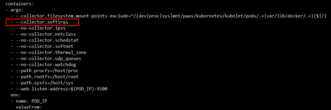

      5. To add a collection item, configure the startup parameters in the ConfigMap. For example, to enable softirqs collection, run the following command to edit the ConfigMap:
        Add --collector.softirqs under nodeExporterConfigOverride.
      6. Save the change and exit. The node-exporter workload is being upgraded in rolling mode. After the upgrade is complete, check the startup parameters of node-exporter. It is found that --collector.softirqs has been specified, and node-exporter starts to expose the softirqs metric.
