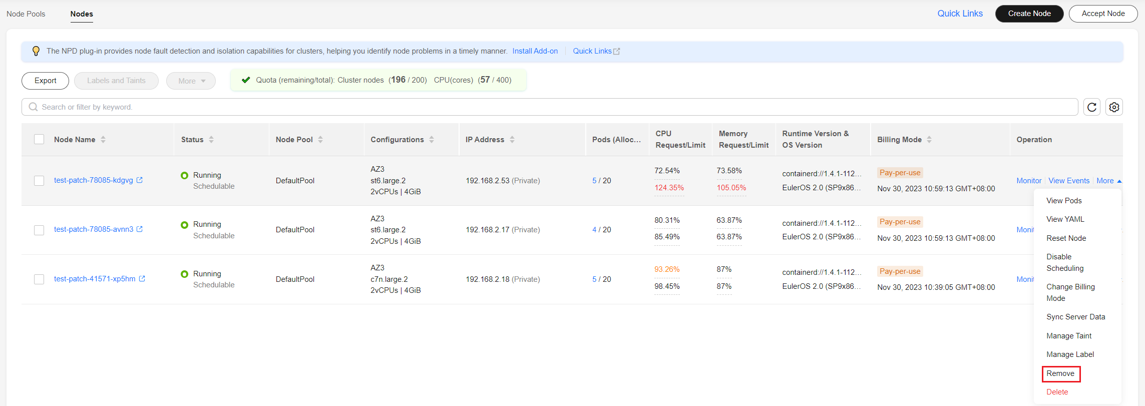

- Log in to the CCE console and click the cluster name to access the cluster console.
- In the navigation pane, choose Nodes. On the displayed page, click the Nodes tab.
- Locate the target node and choose More > Remove in the Operation column.Figure 1 Removing a node
You can also select multiple nodes and remove them at a time.
Figure 2 Removing multiple nodes at a time
- In the dialog box displayed, configure the login information required for re-installing the OS and click Yes. Wait until the node is removed.
After the node is removed, workload pods on the node are automatically migrated to other available nodes.
